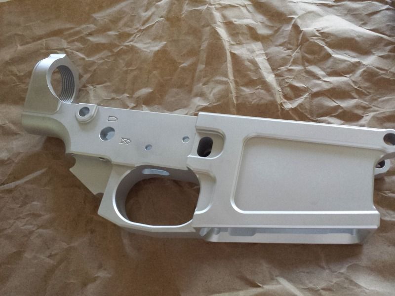

    Incorrect milling/drilling the FIRST time is what killed the lower.
    If it was milled/drilled correctly, it never would have needed to be reworked.
    I think Randall nailed it.
    Whose hands were on the controls, the instructor's or the student's?

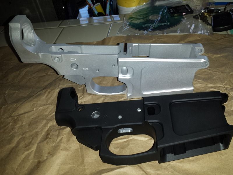

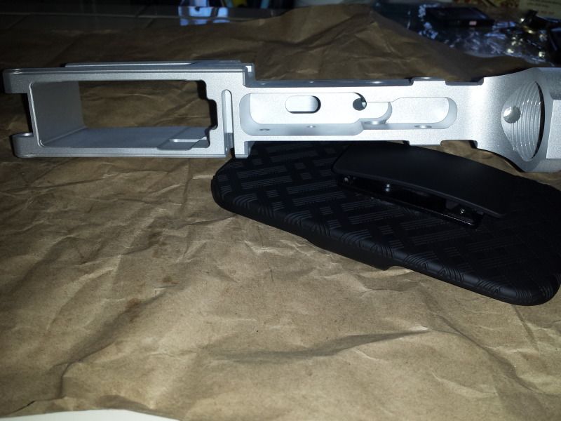

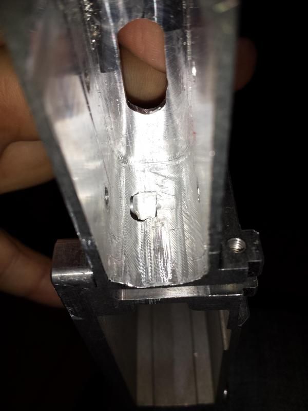

                It looks like the holes were drilled about .03" too far forward and the pocket, well that thing is FUBAR. The blue prints for the pocket size and location are easy to find on the internet, there really is no excuse for this large of a mistake.

                            Looks like a terrible drill press and dremel/ router job on deadbolts lower.

                              ar15barrels
                              • 56935
                              Originally posted by Dr-Death
                              See a Dr.
                              You get Cnc'd then Drilled And Reamed !!!
                              Drilling and reaming should be done before the fire control pocket is cut.
