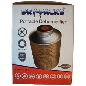

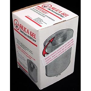

          If your garage floor is concrete - measure the foot print of your safe, go to TAP Plastics, and have them cut a sheet of 1/2" or 3/4" plexiglass.
          Place the cut plexiglass under your safe, and it will prevent your safe's bottom/exterior from rusting.
          If you're planning on securing/bolting the safe to the floor, have TAP drill the holes through the plexiglass.
          Put a big can of desiccant in it and recharge regularly.
          Works for me and HTH -

                    With humidity, yes, things will rust in a garage, even in the desert. I'm in a desert area, and yet all of my tools have some corrosion. When it is humid, it is really humid, like during and after a rain. Also the right combination of temperature and humidity change can make moisture condense on everything. Also occasionaly water gets in the garage from washing things, leaks etc. I'd use a goldenrod, but cannot because it would damage the fireproofing, so I'm using desiccant.
