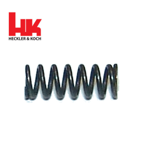

    This site also lists a different part # for USP models - https://www.topgunsupply.com/hk-maga...p-9-40-45.html
    Same as this one
    Check out the deal on Heckler And Koch USP Magazine Release Spring at MGW
    Which makes we wonder if the website listing and spring you are using is not correct and putting enough tension on the mag release, etc.
    It is a $10 part and might be worth it to swap after some research on your end.
    There seems to be one spring for USP Compact, HK45 and other models, another for USP full size models.
    Should have asked earlier, but HK model do you have exactly?

      The mag release on my USP Expert 45 is pretty firm and the magazine has a solid engagement when inserting. The gunpartscorp site I listed has different part #s for the HK45 and the USP for the mag release spring. The site you listed seems to have the same part for a lot of HK models.
      Sounds like the mag release is not engaging solidly with the mags, though if does engage somewhat if you can't pull it out with a slight yank.
      Did you swap the spring, and/or the mag release yourself or previous owner/shop?
      The extended mag release came with the gun from the previous owner. I changed the spring to try and remedy the problem. Then I went and bought another extended release after that (the one I linked above). So basically, the gun now has a brand new release and brand new spring with the same issue. I did also see that the release seems to be a universal part for a ton of different models which kind of had me wondering if that was an issue as well. I want to buy a new mag as a way to rule that out too

      Ok I bought that spring, let see if it works. I have a USP 45

        Try the different spring and see, the other spring may be visibly longer, but you will only know once you have it in hand.
