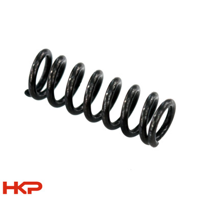

                          The release and spring are here:

                            Spring not inserted into the frame properly? I have this release on all three of my P2000's. I had to guide the spring into the frame with a small knife blade or mini screw driver. If the spring isn't seated properly in the frame the release will feel very weak.

                              The mag release on my USP Expert 45 is pretty firm and the magazine has a solid engagement when inserting. The gunpartscorp site I listed has different part #s for the HK45 and the USP for the mag release spring. The site you listed seems to have the same part for a lot of HK models.
                              Sounds like the mag release is not engaging solidly with the mags, though if does engage somewhat if you can't pull it out with a slight yank.
                              Did you swap the spring, and/or the mag release yourself or previous owner/shop?
