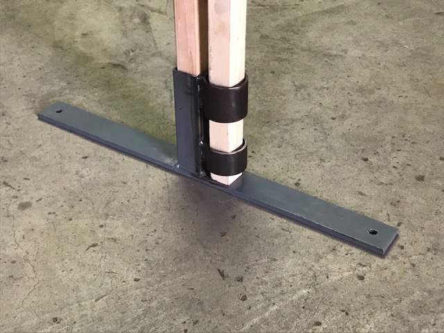

            Originally posted by CamW
            Here are some stands I built for our club to hold walls for our matches.
            The base is 2" wide flat bar, 3/8" thick,24" long. It's made to take 2x2" lumber. The square tubing is 6" long. Holes are drilled in the base for staking down.
            If you're using it in windy conditions, I would use a 36" piece of flat bar for a bigger footprint and stake everything down.
            It`s funny to me to see how angry an atheist is over a God they don`t believe in.` -Jack Hibbs
            -ΙΧΘΥΣ <><
            • #21
              CamW
              • 1719
              The cylinders are for putting the leg of another wall in, if we're putting two walls together we can use three stands instead of four. It's also good for making angled wall arrays or corners.
