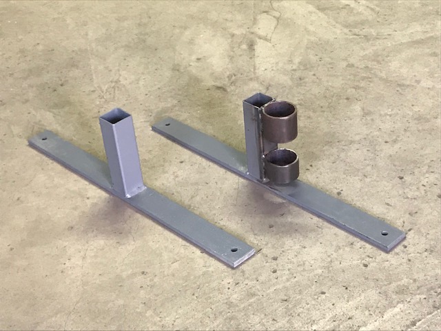

                Here are some stands I built for our club to hold walls for our matches.
                The base is 2" wide flat bar, 3/8" thick,24" long. It's made to take 2x2" lumber. The square tubing is 6" long. Holes are drilled in the base for staking down.
                If you're using it in windy conditions, I would use a 36" piece of flat bar for a bigger footprint and stake everything down.
