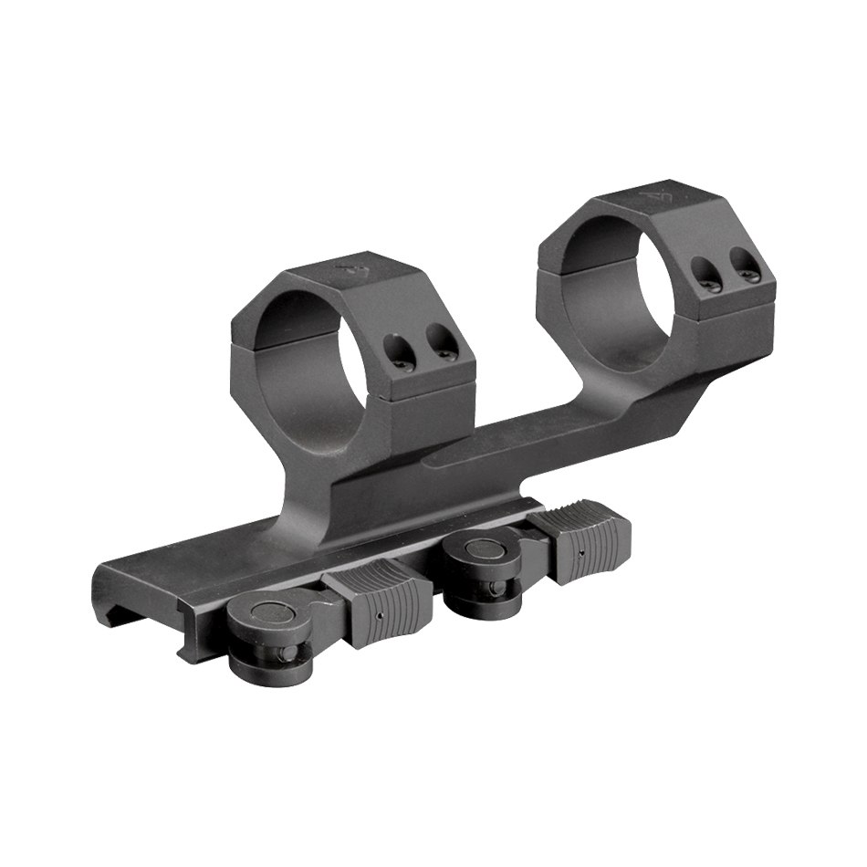

                            Single Large Surface Ring Mount.
                            Wouldn't recommend it for a heavy optic, especially on a heavy recoiling rifle.
                            Just a pic I picked off interweb in answer to OP.
