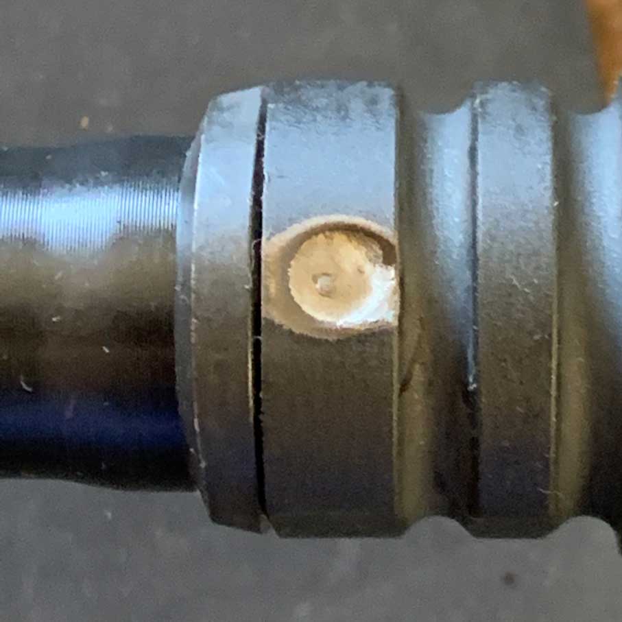

    Randall, if you happen to check back in on this post, would wrapping a wet rag around the barrel and crush washer keep it cool enough to not ruin the spring temper on the crush washer?
    Or could I use a jam nut?
    Problem is, I can't find a reasonably priced muzzle device to get this 13.5" barrel to a tad over 16" without some sort of spacer.
      No need to keep the barrel cool.
      Simply do NOT put so much heat into the welding job.
      One pin/weld is enough.
      Keep the weld SMALL and do it FAST.
      Should come out more like this:
      Can you see the heat effected zone around the actual weld puddle?
      Now look at your pictures again and see how much bigger the heat effected zone is.
      Randall Rausch
      AR work: www.ar15barrels.com
