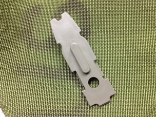

    Anyone have a line on some Gen 2 Magpul PMAG locking plates?
    Magpul doesn't sell them and Magazineblocks.com doesn't have any in stock.
    I suppose I could make the Gen 3's work after a bit of modifying but I figured I'd ask first.

        I was missing a few on my gen 2s as well. I was using magazine blocks block so i cut the top off (left enough for spring to seat and such) and used their locking plate. Seems to work fine.
        No idea where i put the locking plates. They werent with the rest. Odd.

                No luck finding any Gen 2 lock plates so I'm just gonna buy and mod some M3 plates. I'll probably end up buying some of these Magpul Tactile Lock Plates. It'll be cheaper than buying these individual plates from magazineblocks.com.
                I tested on an M3 plate I already own. I just trimmed a small notch into the front of the plate to roughly match the Gen 2
                It'll fit now but the mag will probably only hold 28 rounds or so because of those little legs on the inside of the M3 plates. You'll have to cut them off and sand them flush.

                  Bingo, that's them. Pretty expensive though. I still think modding some of those Tactile Lock Plates is the more cost effective way of doing this.
                  Thanks for the link though

                    You can just trim the mag block too.

                        The ones from magazineblocks.com could be trimmed with just the floor plate part of it left in place.
