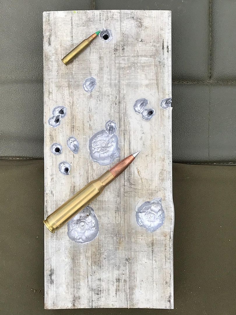

                          I was out shooting yesterday. The plate below is a 2" thick piece of aluminum. The big hits are from a .50 cal DTC at 80 yards. The smaller hits are M855.
                          The M855 hit at the top was from a rifle at 50 yards. The others were from a 7" pistol AR also with M855.
                          Nothing penetrated. The single M855 hit from the 14.5" rifle was the deepest, and about 1/2 way through. I didn't shoot any more with my rifle as I got hit in the shoulder by the projectile which bounced back from the plate. (left a nice scrape)
