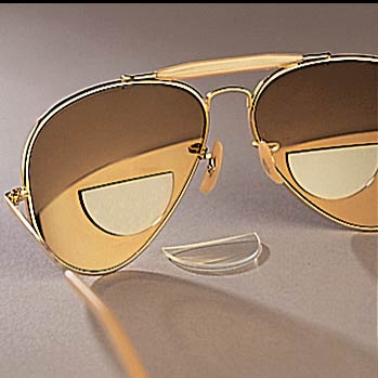

                          I'm trying "stick on bi-focals" now on an old pair of glasses I use to drive (dominant eye only). I'm trying 2.50 diopter. Static holds them on so there is no adhesive residue.
                          Source: http://www.sportys.com/pilotshop/sti...YaAmROEALw_wcB
