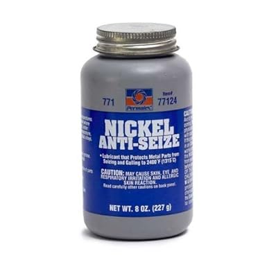

      Update: SUCCESS!!
      I bought a bottle of Permatex Nickle anti-seize and applied it on the choke's thread of my Benelli Supersport and tightened it with the supplied choke wrench. Shot 5 rounds of trap today (125 shells) and the choke remained tight.
      This one:
      Its almost weird how applying lubricant on your threads can result in it not coming loose, I guess the think grease act like filler for the thread and allow them to be threaded together tightly.

        Originally posted by bigbearbear
        Update: SUCCESS!!
        This one:
        Grease decreases the friction between the threads. With less friction between the contact surfaces of the threads it is possible to tighten the choke more for a given torque. There is more clamping force generated with bolts as well if the threads are lubricated for a given torque applied to tighten the bolt.
