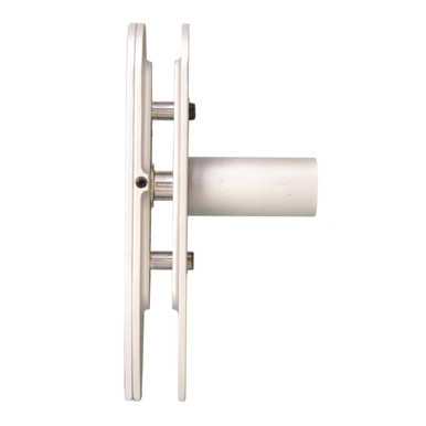

    The GraCoil is a compression butt plate with an adjustable tension setting and adjustable pad plate. Adjustments for length, drop, and rotation allow factor ...
    This might be a little expensive, but a Gracoil and a thick gooey recoil pad like a Kick-Ezz might do the trick.
