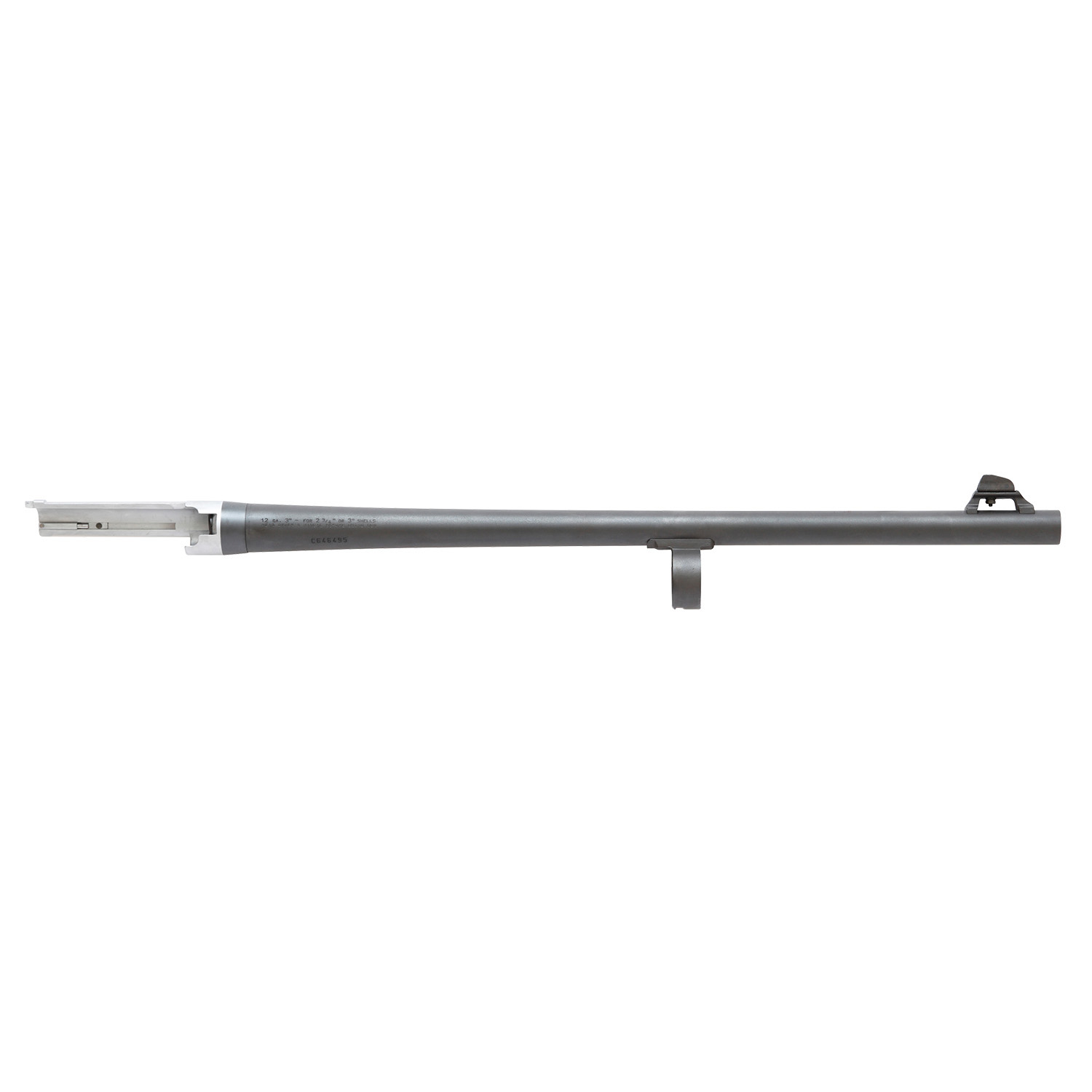

    Originally posted by therealnickb
    Given all the op’s posts, I have a pretty good suspicion of what’s wrong. That said, I didn’t know his sight weren’t adjustable.
    Yeah he is boned. His rear sight needs a 1/2" down adjustment but if it is factory, it is fixed height (windage adjust only) and not even that tall. He could remove it completely and still not have enough. And I doubt someone filed the front sight down because it was never 1/2" either. And the front is soldered on IIRC.
    I suppose he could be using a very unconventional sight picture. But I cannot envision any sight picture through the factory rifle sights that sends the round 4 feet high at 50yd. I feel like maybe his barrel end is tweaked, kicking the rounds up. He really needs to try different slugs and from a bench rest though, and we need to see those sight pics.
    This is the barrel I think we are talking about
        Is your shotgun pre 97 op? If so, here you go.
        https://www.shopbenelli.com/sights-bases-rails/60148
        That requires the receiver to be drilled and tapped. I do not know if the M1 Tac was drilled, judging by all the posts out there where people go through hoops to put a new rear sight on them, I have to wonder.
        And a post-97 takes this but again, only if drilled and tapped receiver
        But both of those, mounting on the receiver, are even HIGHER STILL because the receiver plane is above the barrel plane. So this would be going in the wrong direction to fix a 4 foot high shot. Like I said, even removing the rear sight completely from the barrel will not correct a 4 foot problem. If you could mount the Ghost ring rear, I estimate he would be shooting 8 feet high even on the lowest setting.
        And in any case because those rears mount on a higher plane, they are normally paired with a much taller front sight whose base is again, soldered on.
        M1 & M2 12ga. 18.5" Tactical Barrel with Ghost Ring Sights, Crio Choke, Matte Blued | ShopBenelli
        like this
