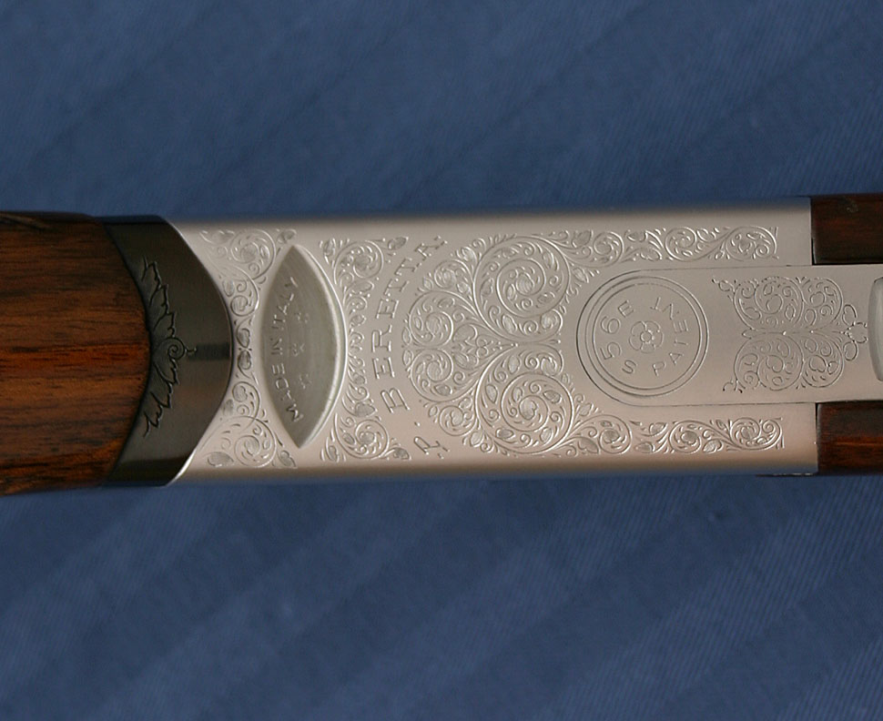

                    This is a 28ga S56E that was sold by Pendelton Firearms. Note the model number stamped into the front/bottom of the trigger guard plate. Some S56Es are stamped on the bottom of the frame, some are not marked at all. If you can get a pic of the bottom of the frame and TG, that could eliminate a lot of conjecture.

                        Very good point, but here is an S56E that is a better match. There are few absolutes with Berettas.
                        OP's gun also has a fore end that is more typical of 680 series field guns. His could be a BL-4 for import to US, but my understanding is that the BL-4 is just an S56E.

                          I have extensively spent 5 whole minutes looking at pictures on google and just can't find a s56e that matches the receiver from the pins to the stepped line and the scroll work I just can't find one... but I can find ones that match the early 686s

                            edit: my google-fu says 686 special
                            If pics load correctly, top pic is OP's gun, second pic is a 686 Special from Silver Creek Outfitters. Note the relationship of the frame bolsters to the the action cuts in the frame. Two different frame designs. Does not mean OP's is not a 686, but I have doubts. Lots of cosmetic variations from year to year on Beretta shotguns makes ID difficult, but this difference looks like more than cosmetic. I guess OP's pic comes up small because it's low resolution.

                                685?
                                Dunno. In the pics OP sent me, the engraving looks too nice to be a 686, so that seems to rule out the 685. That, and the BerBen marking leads me to the S56E, but wood isn't correct for a 56. There were at least three different frame styles for the S56E, and who knows how many different engraving patterns.
