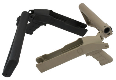

    Hello. This is my first post on this site and need some help with a question. I am new to guns and what is legal and not legal. I really want a .22 rifle and like the fact that the Ruger Takedown easily comes apart for storage. My question is I am not to comfortable with the way I have to hold a rifle and prefer a pistol grip. My question is are the below kits they sell om ebay and online 100% legal to have in California? This is just going to be a gun I go target shooting with and nothing else.

    This is another one I was looking at. I know this one would have to be cut in order to keep the takedown feature.

        As the law stands today a pistol grip is not an issue on a rimfire rifle.
        The issue you may run into with a folding stock like that is that it might be under 26" when folded.
        Federally they measure from the least compact fireable configuration
        California measures from the most compact fireable configuration.
        I have no idea what its length is folded, and it would depend on the barrel length you use too.

            I have the Butler Creek folder on one of my 10/22s. It is 9 inches from the rear of the folded stock to the breech face. It would be under the legal length with a 16 inch barrel so I have to use 18 inch barrels in it.
            The take down uses a 16.62 inch barrel. Check with the manufacturers to see how long their action is when folded.

                The aftermarket stock OP is asking about the legality of folds.
                No the Takedown is not fireable when its taken down so no the 26" is not a concern at that point. But in a fireable configuration under 26" (Which might be possible with a folding stock and the wrong barrel length) it is illegal in CA.

                        AGP now makes a folding stock specifically for the TD. Link:
                          http://www.agparms.com/agp-folding-s...0-22-takedown/
                          Is this a go for California? (e.g. 26" length folded?)
                              Just did a very quick measurement on mine estimating from pictures of the stock; it looks like it falls short of CA standards. Grrrrrrr
