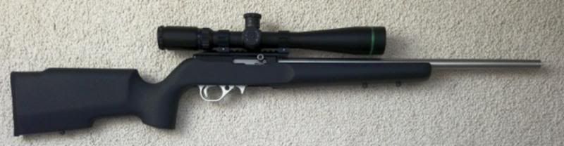

                Originally posted by Biigg50
                ^^^^^ agree completely! [ATTACH]233432[/ATTACH]
                Here is my 12yr old daughter actually "killing golf balls" at 100yrds.
                What's your set up here?
                • #23
                  Biigg50
                  • 561
                  It is a Ruger upper, KIDD bolt, guid rod, spring and handle. KIDD 6oz 2-stage trigger. Clark stainless fluted barrel with KIDD v-block. Hogue stock epoxy bedded. Harris bi pod. And of course the Leupold BR 36 scope.
                  It will shoot cheap Remington Golden bullets 10 shots into an inch at 100yrds, and Federal Auto Match into 3/4" all day long.
                  Very fun to shoot!
