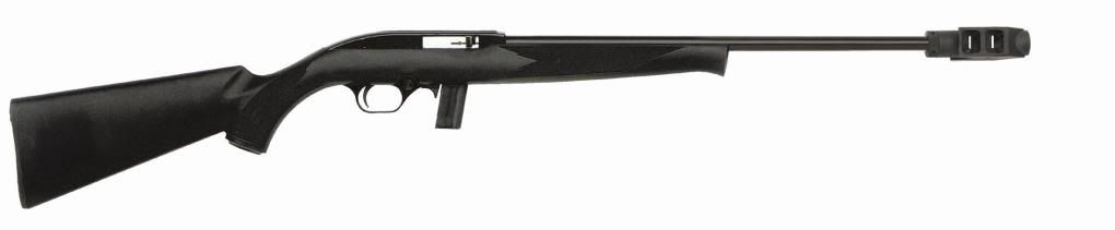

Check out the new Mossberg 702 with the .50BMG style muzzle brake. I didn't realize the recoil on a .22 was so brutal
