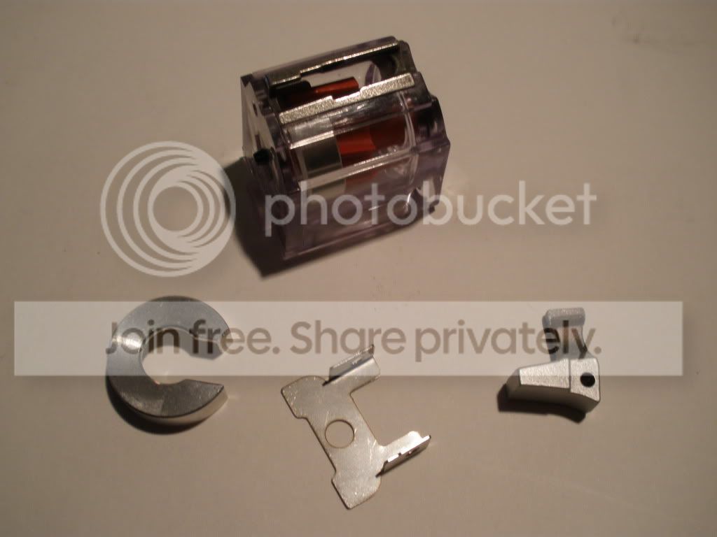

            Charger barrels will fit right on a 10/22 rifle receiver, but this is a big no-no under Federal and CA law without a Short Barreled Rifle permit.
            Do not use a 10/22 rifle receiver to make a pistol, this is also illegal under Federal law.
            The 80% receivers do require a fair amount of machine work to complete.
            This really needs to be done in a shop with the correct equipment, it is not a garage / hand tools job.
            The drill fixture and drill bits kit at your link looks great...certainly will help to make the job easier and better.
            Bullet Button is required and a 10 round max magazine as mentioned above is correct.
            A BB can be made from sheet metal, use the old style flat magazine catch.
            Here's a pic...also showing single shot mag adapter for conversion of Chargers to a single shot for legal CA importation.
            These are all prototypes...regret I do not have enough demand to justify putting these into production.
            Note that this is a standard Ruger 10 round magazine with a dummy extension on it...it is NOT a "large capacity" magazine.
