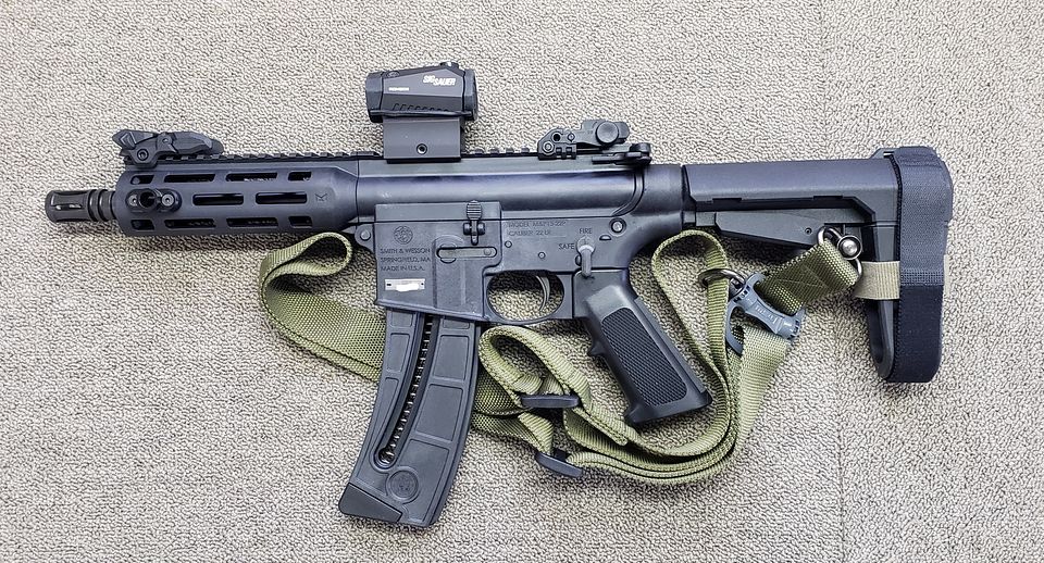

        Originally posted by SVT-40
        The S&W M&P15-22P's are a ton of fun too!! Neat little plinker direct from S&W!!
        I bought my granddaughter a 15-22p. She loves it. I liked it so much I bought one for myself and put a franklin armory binary trigger in it. It is a blast to shoot. We've had no issues with either of them.
