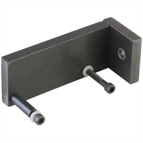

          • #35
            onthefence
            • Jun 2020
            • 58
            Brownells also makes something to drill a hole in the back of the receiver.
            Check out BROWNELLS 10/22® RECEIVER DRILLING JIG with 9 reviews and an overall rating of 4.4, available Online at Brownells Today and many more Rifle Tools products are available in our Tools & Cleaning Department.
                  https://www.brownells.com/tools-clea...-drilling-jig/
                  Everybody is on their own journey, but you really don't need a jig for this.
                  I invested in a center punch and some nice new drill bits, spent about 2 minutes carefully measuring, and just drilled a hole. It's pretty soft metal. No need to over-think it.
                  And I say this as someone who is known for "overthinking it".
