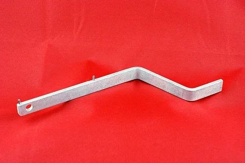

                          I had two 10/22, I shoot both of them regularly and clean them after every range trip.
                          - I clean the barrel from the muzzle with .22 brass cleaning rod. Or you can use aluminum cleaning rod. I never use the steel cleaning rod.
                          - After cleaning of the bolt, this tool will ease the installation of the bolt.
                          Combination tool for 10/22® Extractor Servicing & Bolt Installation! Used for compressing and holding the 10/22® bolt handle/recoil spring in it's compressed position while you easily insert the bolt, and for removing & installing that pesky extractor. Makes extractor disassembly and bolt re-assembly after cleaning, much easier. One end of this terrific tool is an Extractor Removal/Installation Tool. It easily compresses the extractor plunger and spring, and safely holds it in place, while you easily remove, or re-install the extractor. The other end of the tool compresses and holds the handle/recoil spring assembly in it's compressed state, allowing you to easily re- install the bolt. Makes a tricky job much easier! CNC machined from solid Aluminum, with Stainless Steel pins on the extractor tool end. Has a "Hang up Hole" in the end for storing at your workbench. Easily fits in your "Shootin' box" too! This is Absolutely the Neatest Tool Ever Made for the Extremely Popular Ruger® 10/22®. Nothing compares to it! WATCH VIDEO TUTORIAL. For it's great companion tool, check out the 10/22 Safety Tool. 10/22®, and Ruger® are Registered Trademarks of Sturm, Ruger, and Company®

                            https://gunsmithertools.com/shop/ols...bar-lcb7302vsa
                            I just ordered that yesterday.
