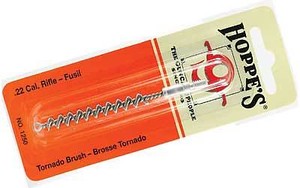

              Winchester ammo was your problem, but generally speaking, the cylinder gets dirty quickly and causes other ammo to get stuck also.
              Tornado brushes are great for cleaning the cylinder because they're so durable and the bristles don't flake off.
