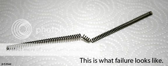

    To make a long story short, I kinked my as new recoil spring in spite of watching numerous videos for takedown/reassembly and reading the Marlin 60 manual. This is apparently a very common occurrence and let's face it- a PITA when it happens (usually first reassembly, as it was for me) and even if it doesn't happen I don't think most people look forward to this part of the takedown process.
    This video's solution is entirely different from method in the manual and other videos. Recommend that you carefully listen to it and watch closely a few times.
    This is the best video I found though it was a bit late for me, but never too late. I was able to re-install my spring (mine was only slightly kinked) easily due to this video. Ordered two replacements in the meantime from Numrich on Amazon before I came across this video. Using hindsight and the benefit of this video, I would've ordered only one replacement spring.

                    I removed the kinked spring from mine (barely noticeable kink- I do not lie) and replaced with a new one. I had ordered additional springs before I had watched the video, darn. Would've ordered just one instead of two. Actually, the kinked spring would've worked okay from what I've read. The 'failure' photo that I posted was lifted from a thread on rimfire central- it wasn't my spring.
