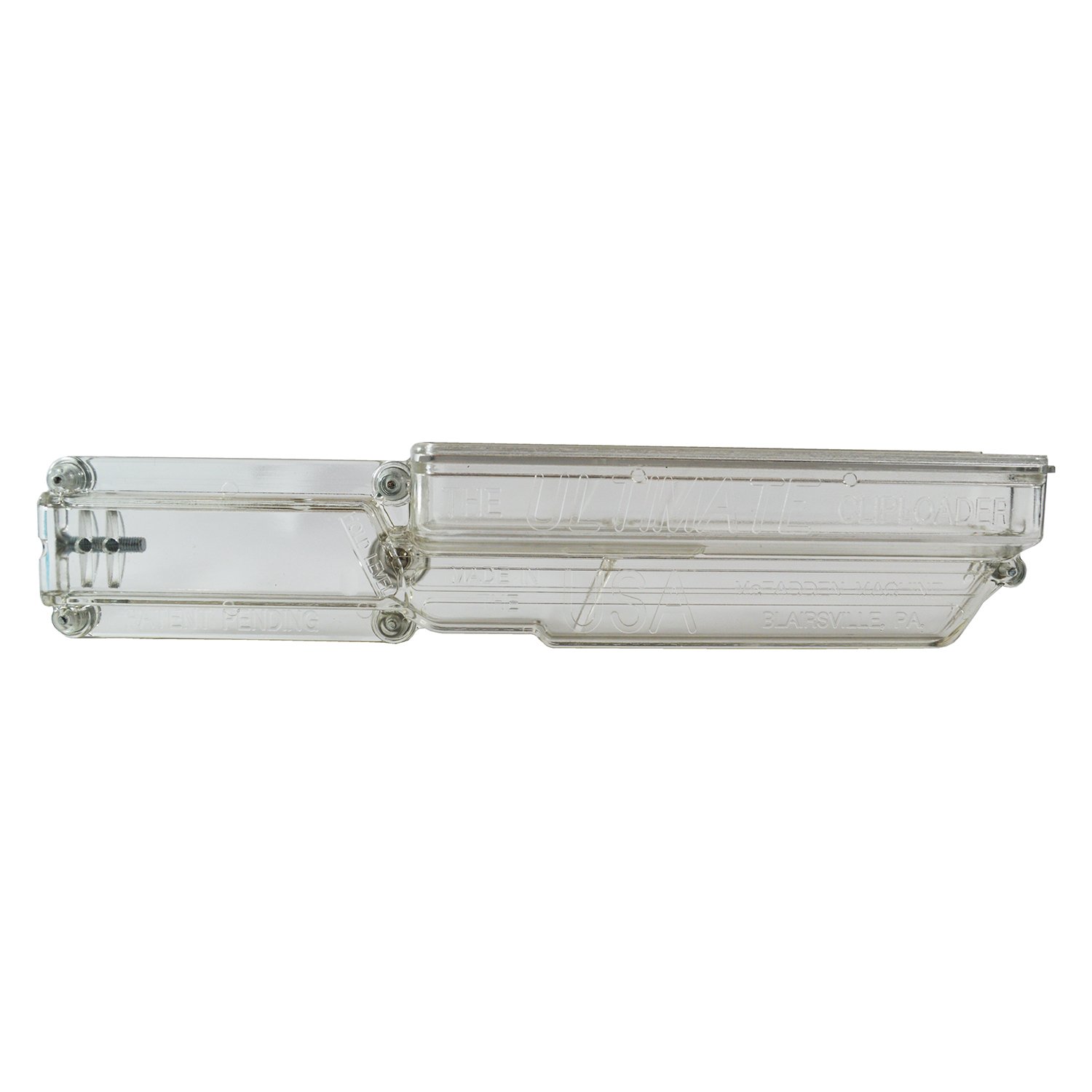

              i was going to get one too, but after taking it apart a million times, ya kinda get the hang of it. Lol. besides $$ can be spent on trigger, disconnect, or hammer bushing
              O and dont get one of these...

                Whoops, sorry i posted the wrong link.
