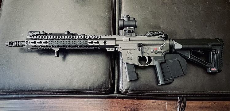

    I have an MRO mounted on an HD Rifle that I haven't shot for a couple of years. Just been sitting in the safe, on and ready for any HD needs. I check it once in a while to see if all is ok.

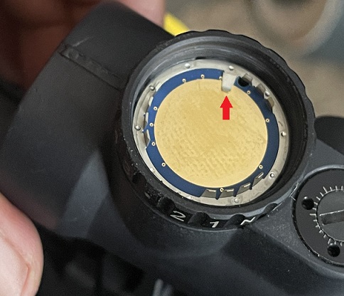

    I checked this week and noticed the red dot was gone. Probably battery. I have stock of new CR2032 batteries for this very reason. I took and one out and replaced the new battery into the MRO.
    No Red Dot.
    I take another one from a different pack and install it, same thing.
    I take the 2 batteries and test them out on another optic, and they work fine.
    So, it's the MRO, not the batteries. I dreaded having to send it in for warranty or repair or I'm not even sure if it's under warranty still.
    Maybe it's just the contact points or how the battery is mounted. I move it around a bit to try and get contact, but nothing.
    I take a little alcohol and a q-tip to clean the contact points, and I discovered this:
    One of the battery holder tabs is bent in. I try to fix it in place and it easily breaks off. This thing is so small and light, you can easily blow it off.
    I took it off with a pair of tweezers.
    I mounted the new battery and boom it works.

    Happy Rifle and Owner again:

      That will happen every time, the battery will not sit properly when a battery tab is bent. You must be gentle with inserting the battery! Glad its working for you now.
