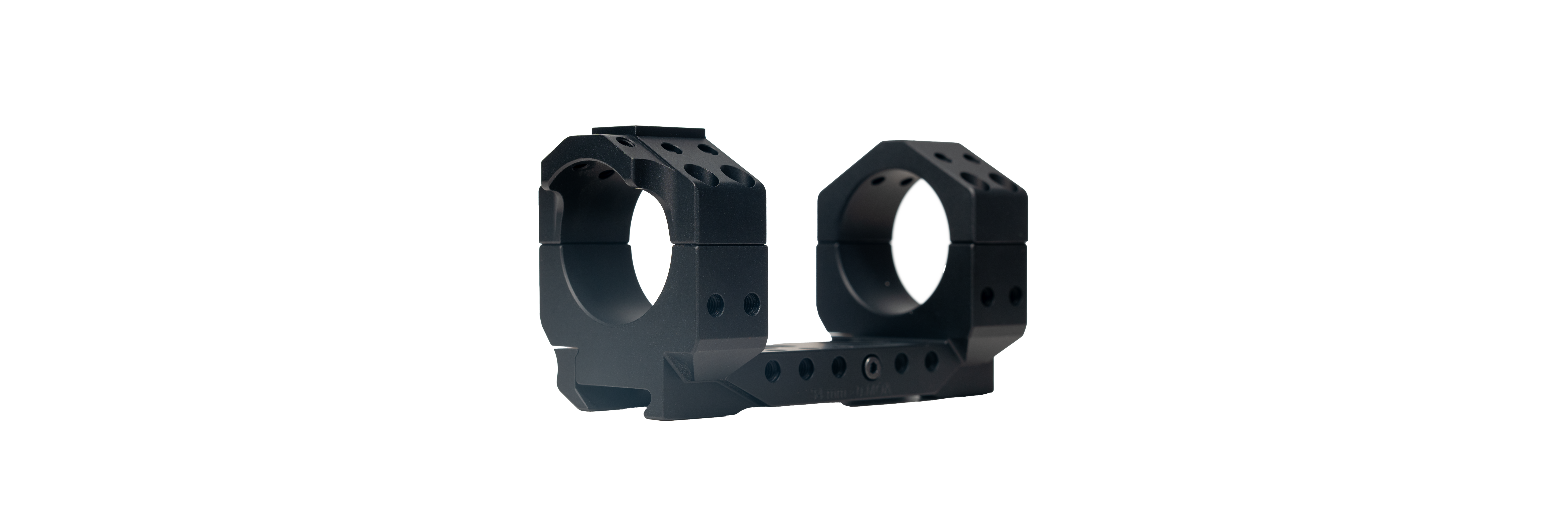

    I like one piece mounts; you don't have to line them up! I put a Seekins Precision 20 MOA on my long range rifle and I am happy with it.
    Aerospace grade 7075 aluminum scope mount featuring the S-LOK wedge system that eliminates rail movement. Includes both 4X and 8X caps — no springs or levers…
    Make sure the scope won't contact anything other than the mount. Do you know what scope you want to put on?
