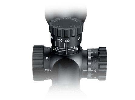

            I think Spot On is good tool for someone who is learning, it helps people understand the concept of ballistics, working with their scopes, and how to conceptualize a shot, but as someone who has experience with setting up a firing solution and building a dope sheet… I can’t stand the software, heck I don’t even like their scopes that much, primarily due to the way they are setup.
            Everything is in inches and in “clicks”… Its all scope model specific, and unless I’m I don’t see it on the website, nothing is translated into MOA or MIL for correction. Getting correction in inches of drop at an unknown distance is just silly.
            I feel it doesn’t really teach you anything to move forward with ballistics aside from what holds they provide and how many clicks to move a dial. The software feels like it’s designed to keep you stuck inside the Nikon family of scopes…
            If you take a close look at everything in their P and M series of scopes, it’s all 1” tubed optics. Nothing they sell is really designed to dial… it’s all pretty much a hybrid, hunting scope made to look like a target scope including many of their high magnification targets scopes… Even the Monarch 6-30x50 is a 1” tube with 30 MOA of internal correction, all for a whopping $1000
            Makes you wonder what they were thinking when they designed it.

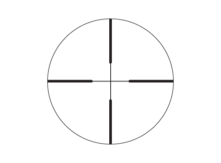

                Going back to your comments about BDC, dialing, 1” tube, elevation travel and dialing… Here is an example of the Nikoplex reticle model… You either just trust the dial, or count 1/4" MOA clicks till you get what you want.

                  In that scope, I'd not dial it. The turrets are one other inevitable part of the scope that are very weak in cheap scopes.
                  The example I gave was to illustrate that BDC shooters don't really need to dial. BDC shooters are for people learning and not shooting very far or with cartridges of ballistic efficiency. I suppose, if you wanted BDC plus a dialing reticle, something like the H59s work because you can shoot all you want at closer ranges without moving the dial since the marks are all provided, then for shooter further, the scopes with the H59 reticles act the same way normal scopes do. However, getting an H59 normal scope is then going to put you in a more expensive league (over $1,000) so you will have other options on the table as well.
