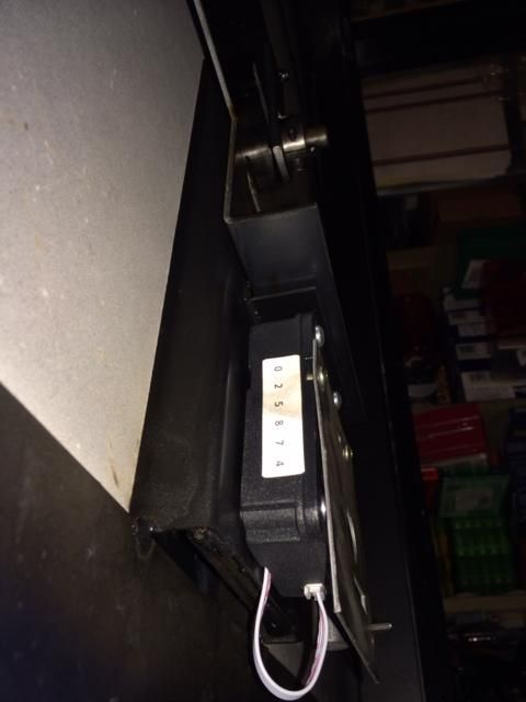

                    I'm working with a Cannon Scout Fire Safe.
                    First thing I did was remove the inside panel covering the door's interior guts. I'm not sure what the correct procedure is for doing this but the way I did it was to slide some rigid plastic on the sides of the panel and pulled until the sheet rock bowed enough to be able to get my hands behind it - then just lifted it out of the channel. You need to be careful as I'm sure if you go at it balls out you're going to break the sheet rock.
                    You can't see the actual lock mechanism from the first pick, its being blocked by the relocker plate. You can see the lock mechanism in the second picture.
                    Now - before I got to removing the parts, I needed to see what kind of lock I needed to replace it with. My neighbor IS a locksmith and told me that the most common lock for safes are Sargent & Greenleaf (S&G) model 6730. But that there are other types of S&G locks and that I would need to check to see if the holes in my safe line up to match the holes for and S&G 6730.
                    Sure enough - its a match (luckily that same neighbor brought me home 2 S&G lock kits to fit and match - saved me the hassle of buying and returning trying to find the right fit).
                    These two videos show how to remove the SecuRam digital lock and how to install an S&G lock.
                    remove the digital lock:
                    Install S&G 6730:
                    When I'm done switching out the lock completely I'll post the before and after picks.
