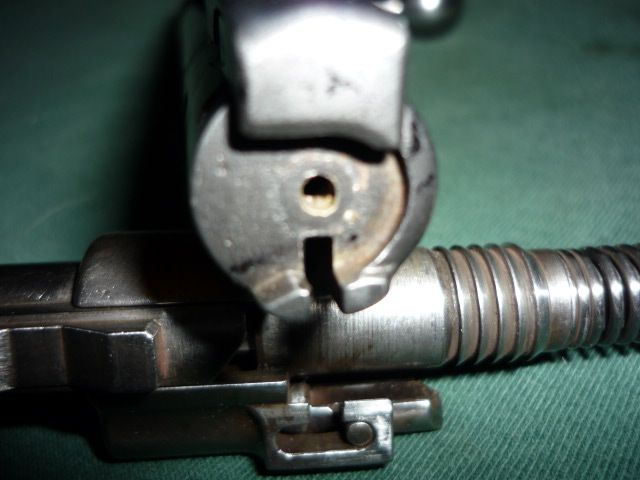

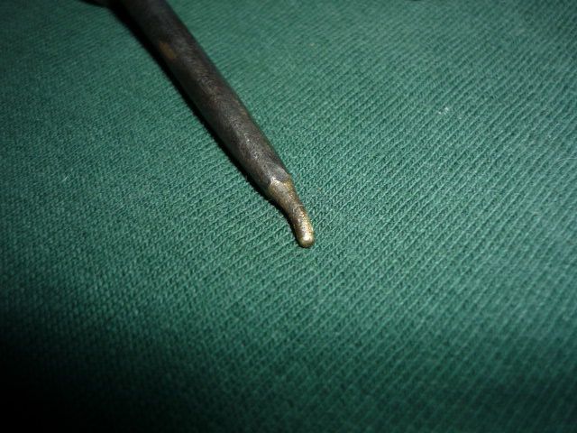

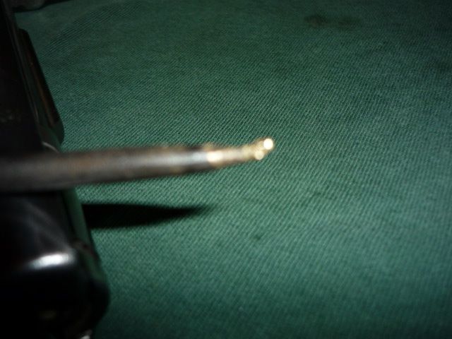

                        Crunch made an important point about small ring Mausers. "IF" something lets go, there's no gas shield on the bolt shroud to save your face.
                        This is the result of a pierced primer on a Brazilian 1908 7mm 98 large ring that happened at the last Norcal shoot. The brass from the primer, was plasma blasted back into the bolt body. It melted the firing pin, and etched out the FP hole in the bolt face. There was brass that vented from the bolt body vent holes, "brazed" to the inside rail of the receiver, and some that was stopped by the shroud's gas shield. This was just a pierced primer.
                        Exact cause isn't known, but this was a 1916/FR-7 in ".308 Winchester".
