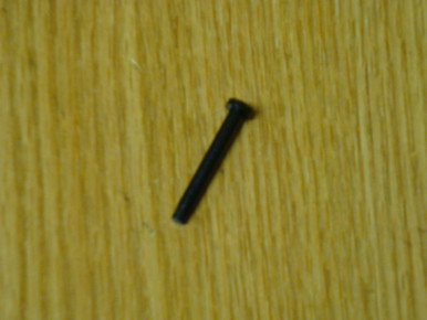

            Anyone know where I can find a screw for this? I dont believe they have the proper screw on their website, they have the one for the swivel, but not a cross screw.
            I found one at Sarco, it is for an A3 though. Will it work still?
            I think I may have figured it out, and it is no.
            Find information, resources and relevant links for billricca.com. This domain may be for sale.
            But, he has them.
            I'm all done for now, the only thing I am questioning is the band spring. I was not able to find one for a 1903,but, I found a A3 model. I could not get a straight answer of if they were interchangeable though.

              The lower band springs are functionally interchangeable, but don't look the same.
              Bill Ricca's item Y1 is the correct upper band screw, but he has a $20 minimum order.
              You might want to try eBay.
              Lower band spring:
              Upper band screw:
              http://www.ebay.com/itm/U-S-Military...item335a7e1ae0.
