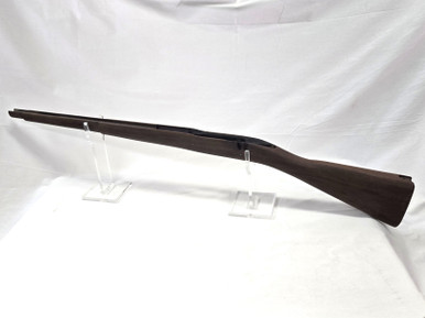

                omnitravis
                • 1233
                Yeah, I'm in for some heavy restoration. No, it is not a marine corps rifle, doesnt have the hatcher hole or any of the other signs.
                Anyone have an extra original stock lying around? lol
                Anyone have any experience with these guys?
                I'll need a handguard, lower band + screw + swivel, upper band + screws + swivel, stock and a lower band spring.
                I'll come in pretty well under what a decent 1903 is going for if I get all this for $200.

                  Rustybore
                  • Dec 2010
                  • 85
                  I haven't had good luck with parts from SARCO.
                  I got a lot of junk repro parts, wrong parts and wood parts that were not as described.
                  Their customer service is not so good.
                  I mostly buy parts and stocks from the following, at least you get good stuff.
                  Liberty Tree Collectors:
                  Springfield Sporters:
                  Bill Ricca:
                  Find information, resources and relevant links for billricca.com. This domain may be for sale.
                  Numrich:
                  '03 parts
                  '03 Stocks/handguards
                  Numrich is kind of a toss-up, most of the time you get USGI stuff, but sometimes they will slip you a repro.
                  Read the descriptions carefully; New made = Repro...
                  Rb.
                    omnitravis
                    • 1233
                    Thanks Rustybore. You put the liberty tree link for both it and the springfield sporters, by the way. I was confused at first.
                    Will A3 parts work on a 1903? Specifically the ones I need?

                          Mustang
                          • Aug 2007
                          • 5075
                          The A3 handguard is completely different than an 03 handguard. Many of the replacement stocks will work for both the A3 and the 03. The A3 bands, while not correct for the 03, may work. The correct A3 bands are stamped while the correct 03 bands are milled.

                              Rustybore
                              • Dec 2010
                              • 85
                              Like the above posters said, the latter (WWll) replacement stocks will work for both the '03 and the '03A3. The handguards are totally different. The stock bands and sling swivels for the '03 are milled, the ones for the '03A3 are stamped metal. Ebay could your best bet for some parts, specially the stock and handguard.
                              Sorry for the wrong link, it is fixed now.
                              You can also take a look at Northridge International, they seem to have some stocks.
                              Rb.
