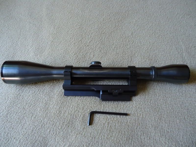

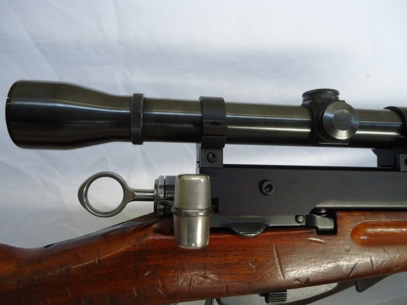

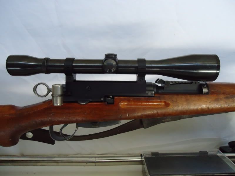

    I completed my Swiss K31 Scope installation today! After many hours of research (Calguns, Swiss Rifles, etc.), this is the finished product.
    Swiss Products Aluminum K31 Clamp-On Scope Mount
    Vintage Weaver K6 60-C Scope (6x fixed; 1" steel tube, thin cross hairs; El Paso glass)
    Warne 7.3/.22 Series Steel Scope Rings #721M (Black Matte, Medium Height)

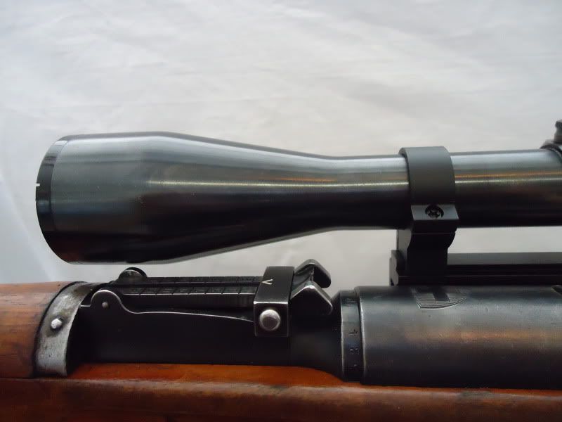

    The K6 scope is 13 5/8" in length, 1 15/16" outside front bell diameter. The Warne medium height steel scope rings just clear the rear open sights, but it does have clearance. I wanted to mount the scope a low as possible, but have rear sight clearance and this worked. I can adjust the eye relief, as well.
    I'm very happy with the K6 vintage look/feel and love the Swiss Products Clamp-On Scope Mount on my K31!

        It looks good? Does it move around or wiggle? Does it scratch the frame?

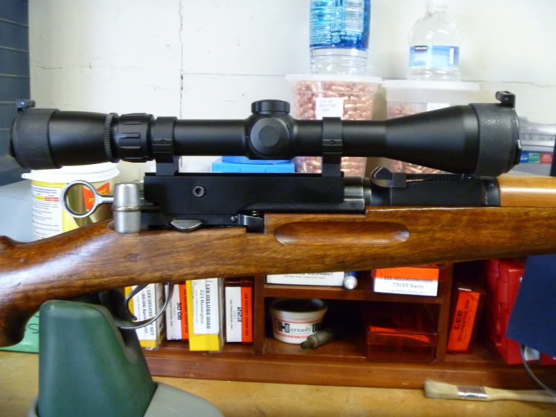

              Looks good! I have the same set up except for the scope. It barely clears the front sight also. Been solid and has not moved after 200 rounds.
                Nope. It locks in solid and has never scratcjed anything.

                  The Swiss Products Clamp-On Mount is a very precision assembly. It attaches with a small clamp in the K31 thumb slot and aligns solidly to the right side of the receiver. No rattles, no loose hardware, no scratches to receiver and no drilled holes...very ingenious!
                  The Vintage Weaver K-series scopes are an all-time favorite. I planned on using the K4, but found a good deal on the K6. They have steel tubes and caps (no plastics), which the Swiss would appreciate. Both are good scopes and easy to find on Ebay, etc.
                  The Warne "medium" height (.406") ring was my biggest concern for clearances, but I was lucky and they just fit.
                  My total scope project cost was under $200, which saves me money for my next K31!

                          Those are Warne 7/3 rings, yes? Is the scope mount slotted or does clamp pressure hold the rings in place?

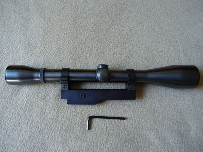

                            dfletcher:
                            The scope rings are listed as - Warne Scope Mounts "7.3 Series" Permanent Ring 1" Med Matte #721M. They are priced at $26.99 at Brownells. This is not to be confused with a Brownells/Warne 7.3 Ring that is heavier duty with four mounting screws (2 each side) that is priced at $39.99. Just search for the Warne #721M rings.
                            After installing the Swiss Products Clamp-On Mount, the scope rings clamp to a 3/8" dovetail rail on the top of the mount. The rings can slide on the dovetail for adjustment. Hope this helps.

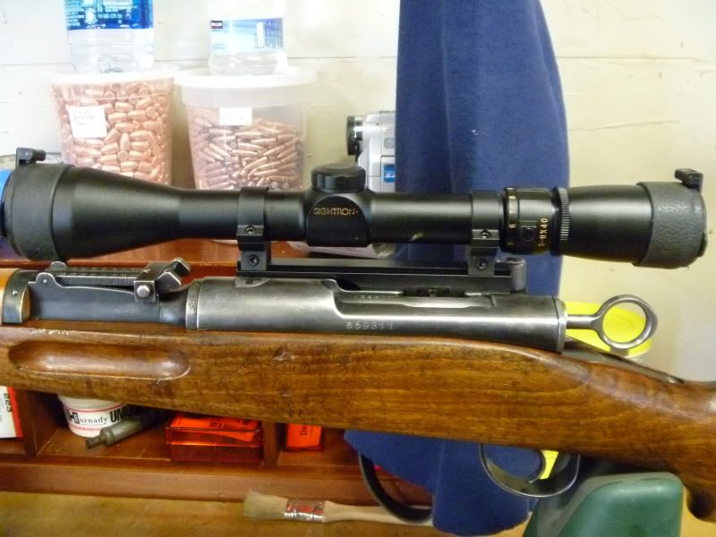

                              Originally posted by OldShooter32
                              I put a inexpensive (cheap) Tasco on my K31
                              Blasphemy! How dare you put on a cheap Chinese (I think they are no longer made in Japan) scope to a finely made mechanical devices.
                              Did you fix that extra tight lockup on that new Garand?
                              Here is my rig with a Burris 6-18X glass and one piece ring.
