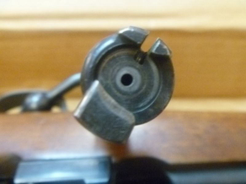

            It is a Mauser 98 style action. Once can tell by the depth of the thumb notch. 98s have a deeper thumb notch than the small ring 95/96s. Plus you can just see edge of the ring in the picture of the left receiver rail that has the word Standard Modello. Also, the left hand locking lug on the bolt does not going all the way to bolt face rim.

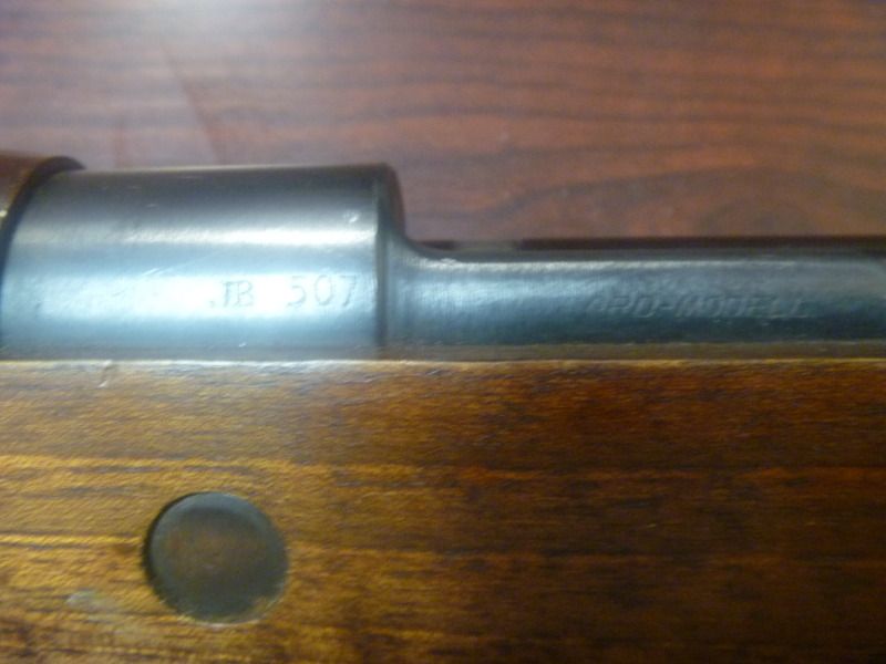

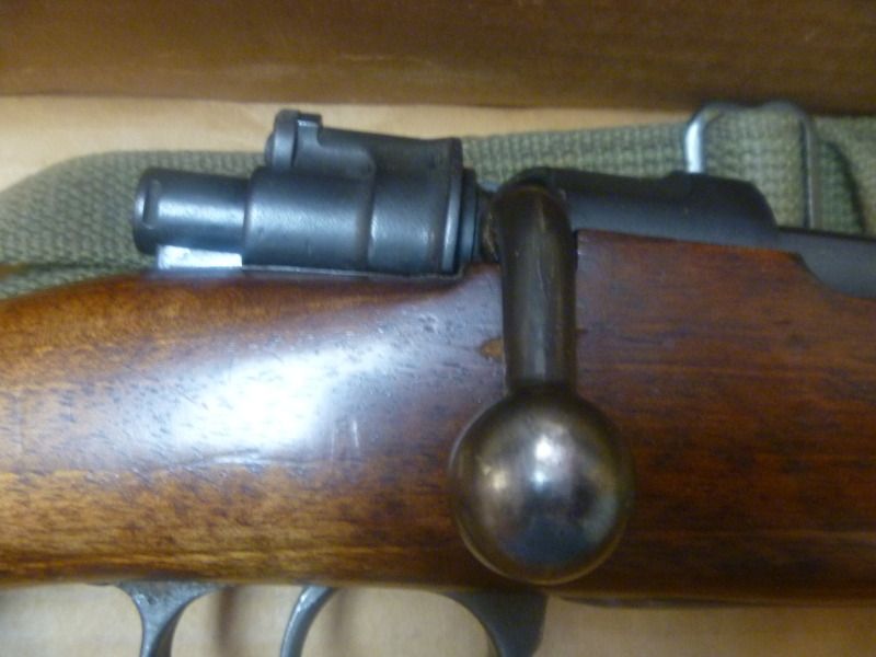

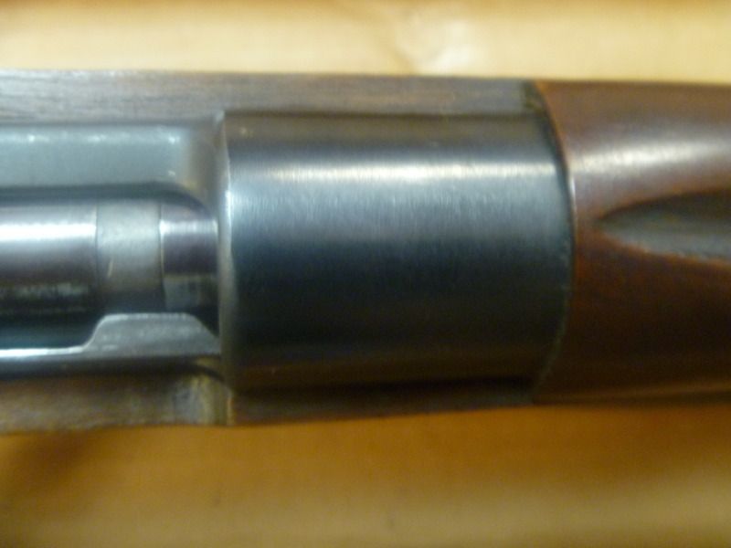

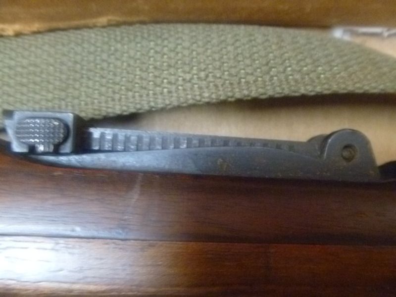

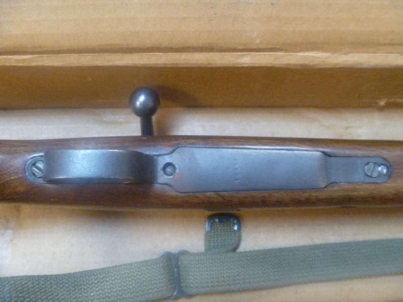

                Thanks for all the info guys! What is an estimated value of this Mauser, and more importantly what kind of Mauser is it?
                Here as some more pictures:

                    Well, it has a U.S. WW2 type M1 carbine sling on it. If it is original and not a reproduction that is worth some money by itself.

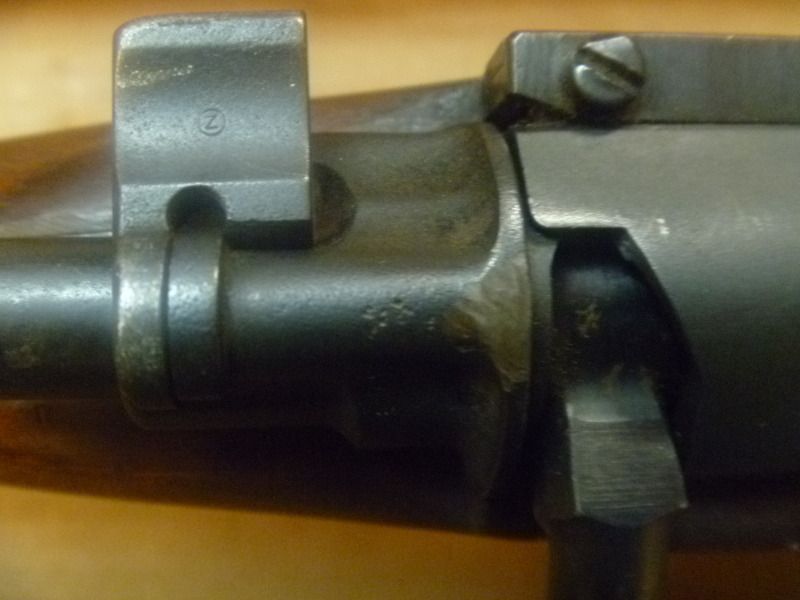

                      It's worth more than $75, buy it. I could swear the circled z is a czech marking.
                          The circle Z IS a Czech proof mark. I can't make a case for the rifle being Czech unless there are other parts with the same mark but I can't rule that out. The general configuration looks a lot like a VZ24.
                          Certainly not a Swede, if that is even a question at this point.
                          Swede Mausers have a straight wrist stock, do not use the "H" style front band, have different front and rear sights than the rifle pictured has, and do not have capture screws holding the floor plate. The butt plate is not right, either.
                          The partial marking including "modell" indicates civilian production. At that point my knowledge is murky, but I'm thinking that Gun Toting Monkey Boy is on track.
                          It [I]might[I] [be chambered in 8mm mauser, it is unlikely that it is [I]not[I]however putting an 8mm round in the chamber and pulling the trigger is a REALLY poor way to prove this one way or another.
                          But 75 bucks for a Mauser, you CAN"T go wrong, really.

                            I believe that the only company that would put Standard Modello on the side of the receiver would be Mauser. If that is the case then the front ring should have the should have the Mauser banner on it. Since the Mauser banner is not present, then the receiver has been scrubbed.
                            The bolt shroud has grind marks at the top. This was often done to get rid of the German/Nazi Eagle and Swastica proof markings that were often stamped there.
                            As for the bore, take a 30 caliber bullet and see if it drops down the barrel. If the bore is 8mm, it will drop freely. If it is one of the 30 cals (308, 30-06, or the 7.65 cal) the bullet will not completely enter the bore. That will at least narrow it down.
                            But again, for $75 it is a steal.

                                Looks like a VZ 24 stock with a K98 bolt, barrel and a Mauser commercial receiver.
