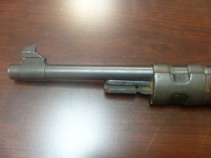

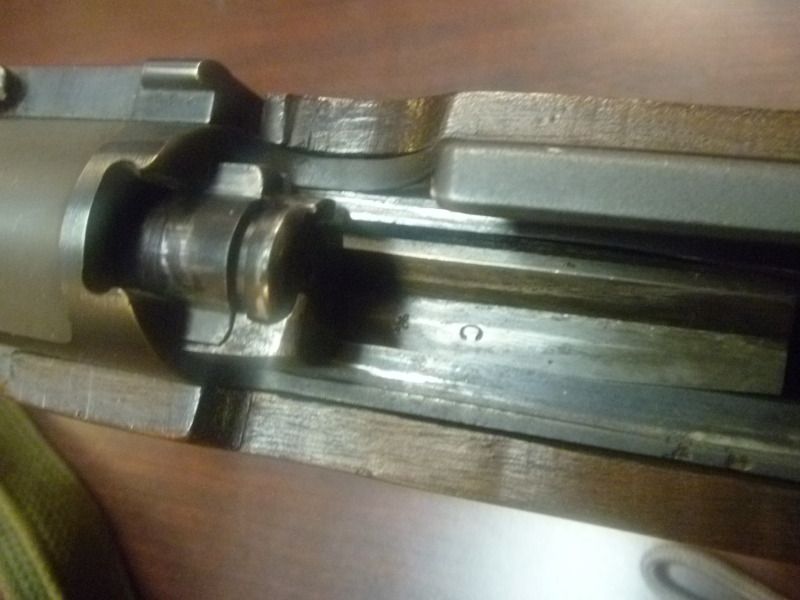

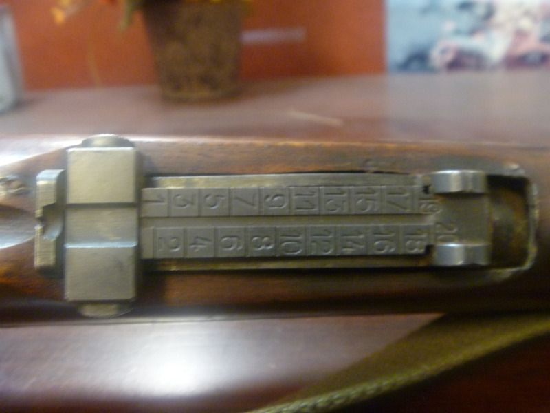

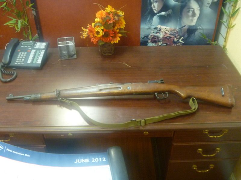

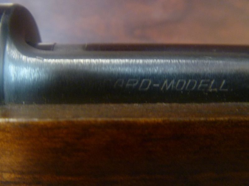

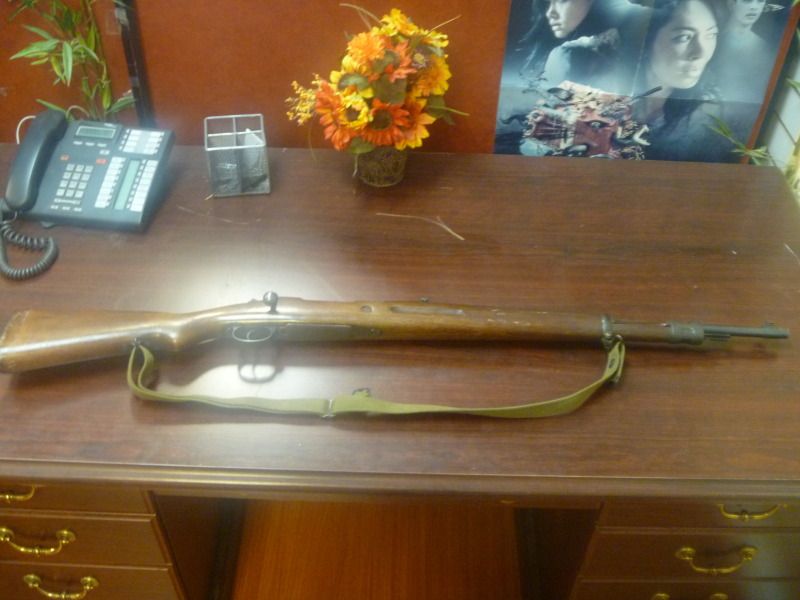

    Update: I was able to take a few pictures. I hope this can verify hat kind of Mauser it is.

                        The Swedish Mauser has a round bolt face, the Spanish 1916 has a flat section at the bottom, there is also an oval gas escape hole in the side of the Spanish Mauser receiver.
                          Low-Pressure
                          • 1758
                          I guess the picture rules out a Spanish Mauser.

                            TRAP55
                            • Jul 2008
                            • 5536
                            Looks like a pre war Banner Mauser. Get a pic of the top of the receiver ring.
                              PEZHEAD265
                              • 980
                              It looks like from the bayo lug that it is from the 98 family.Like TRAP55 said pics of the receiver will help.
