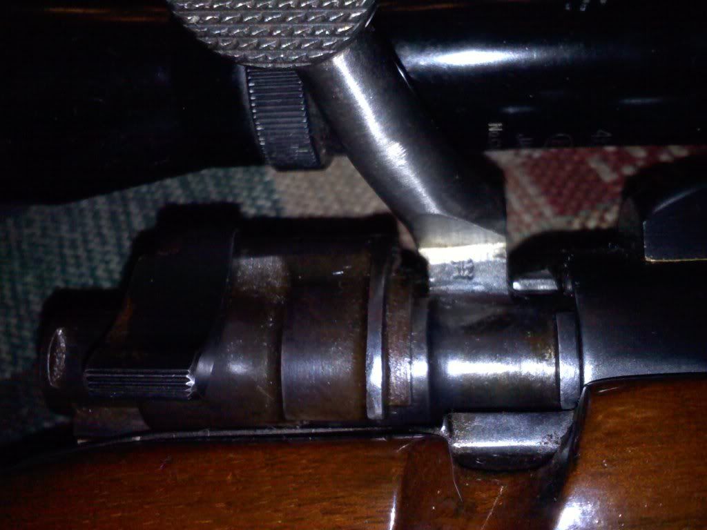

    I just picked up a couple of good looking 98 and would like a little help ID'ing them. I'm bran spanking new to the C&R craze and starting to really appreciate the older rifles. Here's some pics I appreciate any help sorry about the size of them I'm still a little new to the posting pics thing

    It looks like a German Kar.98a that has been sporterized, rebarreled, reblued. The date of manufacture and factory are probably marked on the receiver under the scope base. Is the new barrel in .270 Winchester?

      It is a sporterized and refinished Kar98a. Here is what it looked like originally.
      The Kar98a was produced during World War I to provide a shorter, handier rifle for cavalry, artillerymen, etc. However, its handiness compared to the standard Gewehr 98 battle rifle made it popular with front line troops in the trenches. By the end of World War I the Kar98a accounted for approximately 40% of German rifle production.
      Unlike the Gewehr 98 and later K98k the Kar98a uses a "small ring" receiver that is narrower than the Gew98 and K98k.
      Top to bottom: 1916 DWM Gewehr 98, 1918 Danzig Kar98a, 1935 ERMA K98k.

        thanks for the replies it is a 270 win. That brings up another question, being that it is a small ring would it be okay to use factory ammo in this or not. I hear that the small ring is supposed to be weaker?

          When you hear about small ring Mauser actions being weaker, people are probably referring to the pre-1898 small ring actions. A small ring 98 action like that of the Kar98a is easily strong enough for .270 Winchester.

              The Kar98a was designed to use the 8x57mm IS cartridge. The maximum European standard pressure for that round is 56,564 psi (SAAMI spec is 35,000 psi for safety in pre-98 rifles). The SAAMI spec for 270 Winchester is 65,000 psi, so I would not use maximum power 270 Winchester rounds in that rifle.

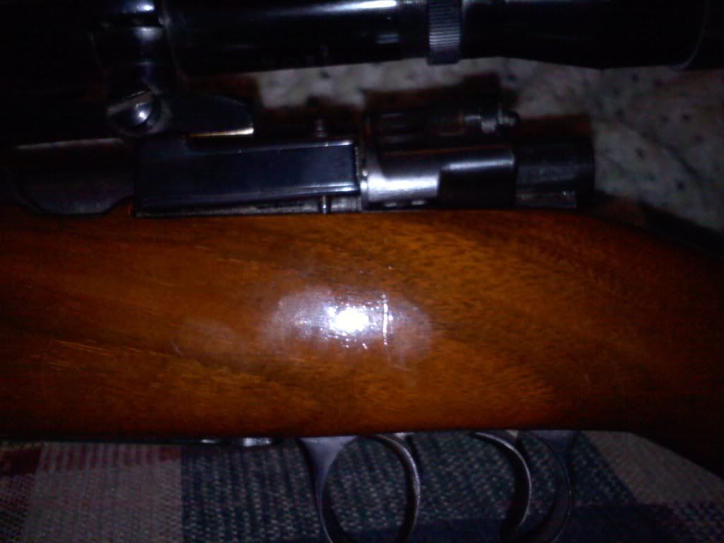

                        Like this This gun also has a double set trigger I don't think this is original but does it make it more valuable or less, I would like to make this into a deer/pig hunting riffle but if I can't use factory ammo I might have to go a different route

                          If you handload you can make ammo that is under the pressure limit.
