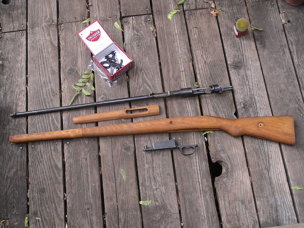

                Turkish Mauser long rifle kit
                I think the OP is requesting about other folks' project guns as well.
                Here's a Turkish Mauser long rifle project. It's an unissued stock with nice striping which will need inletting and sculpting from the outside. I have two different bolts to choose from, a bent and a straight bolt. Since this project will produce a non authentic rifle, it sort of doesn't matter what I do to it.
                I have choices. If I want to scope it, I can put on the bent bolt. The existing bore is OK, but I'm toying with putting on a brand new target barrel and contour the stock to fit the new barrel. If I don't scope it, I could put aperture sights on the rear and a nice thin blade sight on the front. I'd have an excellent barrel with iron sights and a very long sight radius. That's sort of attractive. I already have several period Turks, so with this one, the price is right for me to make a build. 8mm Mauser is a great round, so I'll keep the caliber.
                I spent the better part of the summer getting all the small parts. The only parts that haven't arrived yet are stock take down discs. I'll hook them together with an annealed brass tube attached using a custom tool that chucks into a drill motor. I'll make the tool from an old spade bit. I grind it so it will roll the annealed brass over the stock discs.
                I have had good luck with pine tar as a protectant and stain. I'll finish it with thinned boiled linseed oil.
