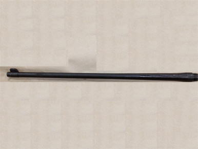

              Not a 1943 dated barrel, and not sure if this is a 1903A3 barrel (they advertise it as a 1903 barrel) at BRP for $275, but it is advertised as dated 1944:

                highpower
                • May 2012
                • 5303
                parts for antique machineguns: WW2, MG34, MG-34, MG42, MG-42, STEN, BREN, SMLE, Vickers, Suomi, KP31, M31, KP-31
                I've bought parts at BRP.
                It's an 'A3 barrel. In my internet searches so far, I have turned up two barrels that are almost the right ones, but both were dated 9-43. Just a month too late to be the proper barrel for a 8-43 receiver.

                  These "new, original 1940's production" G.I Surplus 1903A3 Springfield Barrels are currently advertised at Sarco, Inc.. Might be worth a call to see if any would qualify for your needs.

                    Thanks for the heads up. Due to a internet buying frenzy, I now officially have all the parts to build this out, including a Weaver 330 scope and all the metal bits except for a barrel. I'm thinking that the Sarco barrels are cheap enough so that I might buy one to use as a place holder until I can get a correct 8-43 barrel.
