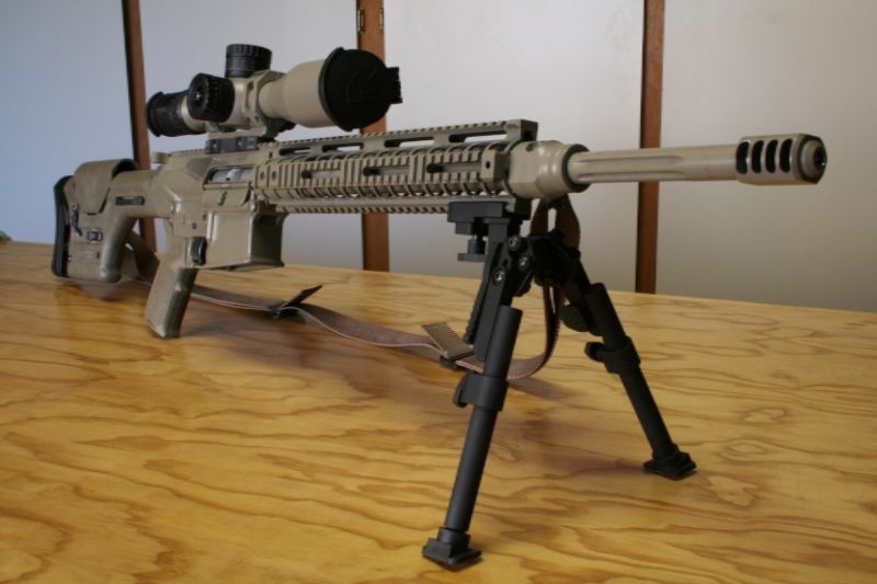

            Not a C&R, but..... As concerns vision, ......This is what happened to Latigo with his Wilson Custom AR10 and an insanely clear and expensive scope...... a Premier Heritage 1,000 yarder.
            She has a custom, internally re-machined Armalite AR10 receiver/magazine well cut to accept a slightly longer AR10 custom magazine, this because of the required OAL.
            All internal receiver areas are coated with a Tungsten Disulfide Matrix derivative. The chamber and throat are cut to accept one projectile profile only. The Sierra 175 MK,
            and no other. Because of these cuts the TTL, seat depth and OAL are specific and critical, thus the need and reason for a custom machined Mag-well.
            Walther 17-4 S/S barrel, internally tapered .006 electro-polished bore and a 1-10 ROT. Moly Specific.
            SWS foregrip and a prototype trigger from his inventory that later evolved into the Chip McCormick trigger.
            The following is the sequence and history of some 1,850 chrono'd and logged in rounds sent downrange, some of which were moa in 5 round groups, but Lat wandered in and out of moa to 2moa week after week. He was getting frustrated. I'll make this as short as I can.
            We used the original Load Data, case prep and the cases themselves were not easy to get. They were to be Lake City headstamped "LR". Those are the USMC Long Range cases that are once fired and collected by a specific case and projectile supplier.
            Prep, shoot... no moa, change the load by 1/10gr increments up and down...... moa once in a while.
            This is what we tried:
            Powder charge change in 1/10gr increments to 2gr under and 2gr over intial data.
            TTL OAL
            Bushing change
            Seat depth changes
            Seat depth and charge changes to 2gr under and 2gr over intial data.... Chrono spread literally tight with the original data, IE: 2505fps. SD +-7
            The above amounted to some 1,800 rounds with one critical change midway through. We found that our Moly process, similar to Sierra's was not deep or hard enough. You should be able to go 7 to 800 rounds without seeing any coppering of the lands/grooves at all. I changed my process to match Stewart's and the coppering after 160 rounds disappeared, but still no consistent moa shooting. Lat was discouraged to say the least. He was about ready to stack it in the armoury and work with his M1 Garand for a while, until..............
            Lat's down prone in the shootshed and I told him I'd been watching his shooting technique all along and judged it solid and correct, but today I had an idea. I had him remove his prescription shooting glasses, put on his contacts and fire 5 rounds. MOA!! We went back to the armoury and reloaded 20 of the original load data we had on day one! 4 moa groups right out of the gate! Back to the armoury for another 20 rounds.........But this time, I had him remove his contacts. Sub-moa! Back for another 10, same results sub-moa!
            So, 1,870 SMK projectiles, pounds of powder, frustration and disappointment was all traced back to something so simple we hadn't considered it. Contacts and prescription shooting glasses. Those contacts did a slight floating action on his lenses and the shooting glasses changed with his prone head position. He could move his head slightly and got a better, sharper picture. That should have told me something, but I never imagined it.
            The Wilson performs exactly as designed, and Latigo is an extremely happy camper. A lot of component dollars lighter.... but happy.
