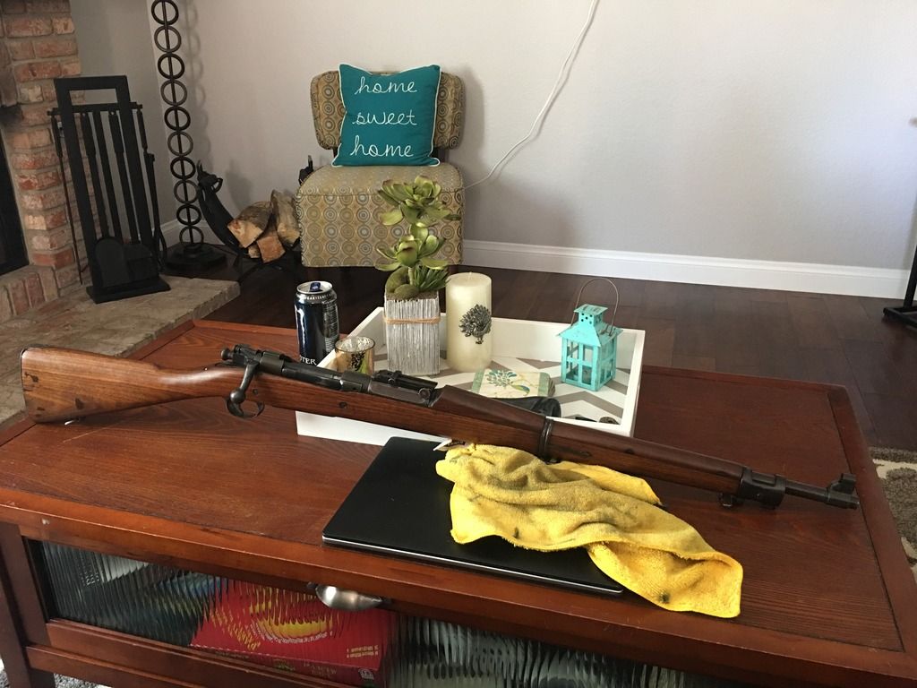

    Here's some pictures of my new beauty. The rifling is strong, but a little glazed and the muzzle wear gauge indicates .3000. I did notice upon bringing it home that the stock is either cracked, or has had a repair job. I'm still trying to determine if it's okay to shoot like this. If not, I might have to keep an eye out for a new stock.
    All in all I'm very happy with my purchase despite the imperfections.

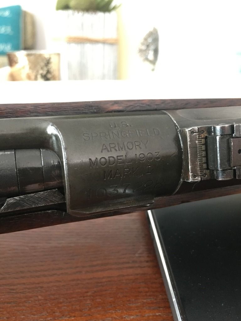

    Finally found a great condition M1903 that came from an estate sale and the metal as well as the wood are also in great shape. My understanding is that it was covered in cosmoline, but was recently cleaned up. The bore is glazed, but has very strong rifling and my muzzle wear gauge barely fit in the muzzle. The serial is 1,03x,xxx which to my understanding is above the range of serials that were possibly affected by the flawed heat treatment.

            Pictures added! Tell me how I did!
              huntingsocal
              • 2319
              Looks like stock is both cracked and had brass pin repair job.
              Hard to say if crack is stable or not. Maybe shoot it and monitor to see if it gets worse?
                It's really hard to tell with my eyes let alone through a picture, but there appears to be a brownish resign that follows that crack. It has a metal recoil lug, so I'm not too worried about it exploding into my shoulder.

                    Is there an elongated cutout on the left side of the receiver?

                        Yes. It has the long slot in the side. Thanks for the video. I had heard very little about the Petersen device.

                          Decided to just keep the factory bolt and not worry about it. The barrel says 1-19 on it so I figure the overall condition isn't bad for being nearly 100.
                          I also found a very faint circle-P embossing on the stock.
                            highpower
                            • May 2012
                            • 5298
                            1-19 dated SA barrel would be correct for a Mk1 with that serial number. I have a Mk1 that is roughly in the same serial number range with a 1-19 barrel also.

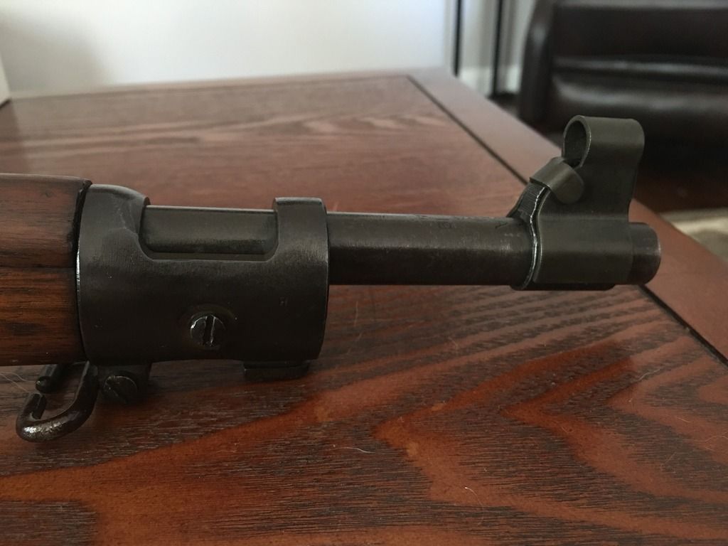

                            Your stock is a WWII replacement. An original stock will be relieved just below the Pederson ejection port and will look like this:
                            If that was the original stock, it would be well worth stabilizing the crack and saving it as they have become rather rare. As it is, I would be on the hunt for a new stock that isn't cracked. The longitudinal crack behind the receiver is common on stocks that weren't fitted correctly or were shot with the action loose in the stock.
                            Look also to see if it still has the original Mk1 cut off as the spindle and cut off are different between standard '03's and Mk1's.
                            This is a Mk1 cut off. Note the "WJS" cartouche typical of Mk1's:
                            Standard '03 and '03-A3 cut off:
