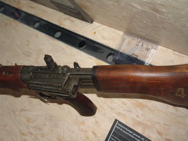

                          I found a photographic example of a G-Type in untouched condition in a Museum (Musee Des Armies, Paris) - it is a similar finish to mine - without the "thick-black" paint that seems to have been applied to a number of examples (see above).
