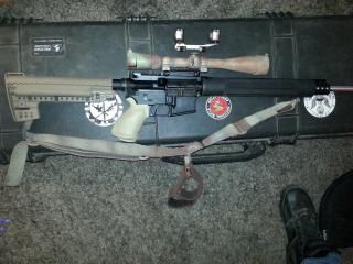

                  I hate them. I have very large hands and long fingers.
                  I have a lot of power tools in the garage..... A couple minutes on a disc sander does wonders.....
                  Then I usually slap on some latex gloves, mix up some bondo... slap the bondo on the grip and lightly get my hand on it to shape the bondo. After several applications, I build up the palm swell to offset my hand to the right and rear of the little girly sized normal grip so my trigger finger placement is correct. Otherwise, I over grip the trigger by a mile, and have to contort my hand/fingers to get correct finger placement.
                  Most people that have shot my rifles with this, like how it feels... unless they're a lefty....
                  This is not a regular A2... but has the bondo treatment. You cant see just how large the palm swell is...

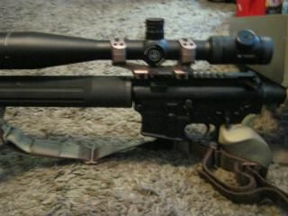

                    postal
                    • 4566
                    Other side... you get an idea how thick the grip is seeing the thumb shelf..... (same rifle... sporting some new glass) Yes bondo is strong enough for this little wimpy 556 recoil.... If you change your mind, it's easy to break it off with a hammer or something... but it will stand up to recoil.
