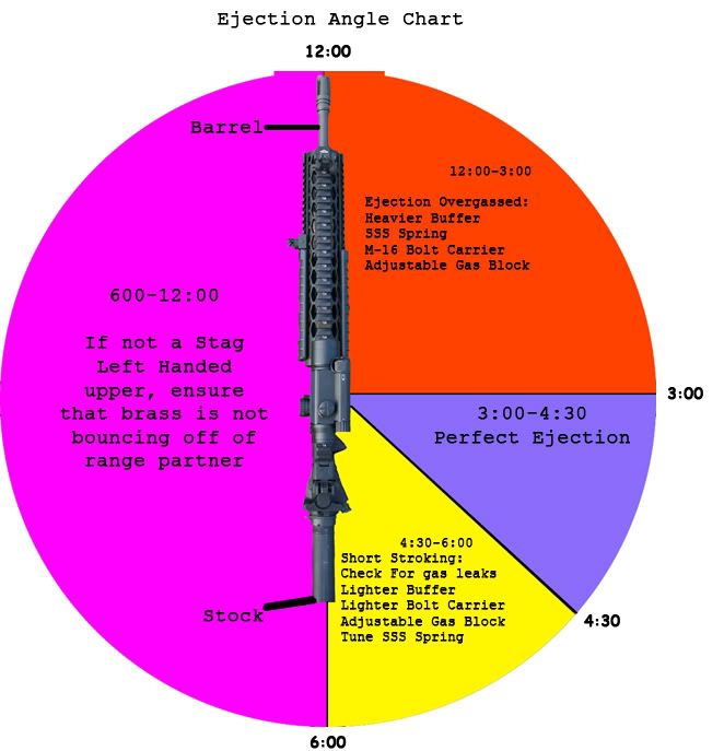

                            http://www.calguns.net/calgunforum/showthread.php?t=839619
                            Quick reference to troubleshoot timing/cycling. This should address any concerns about short barrels not cycling or the like:
                            Not my picture. This belongs to AR15barrels:
                            Barrel length means nothing until you bring the gas system length, the cartridge and the bullet weight into the fray as well.
                            Different buffers allow you to tune a gun to run at it's optimum.
                            Ammo is also a big factor in which buffer to use.
                            Anyone that tells you a specific buffer is what you need for a specific barrel does not know what he is talking about as there are no absolutes here...
