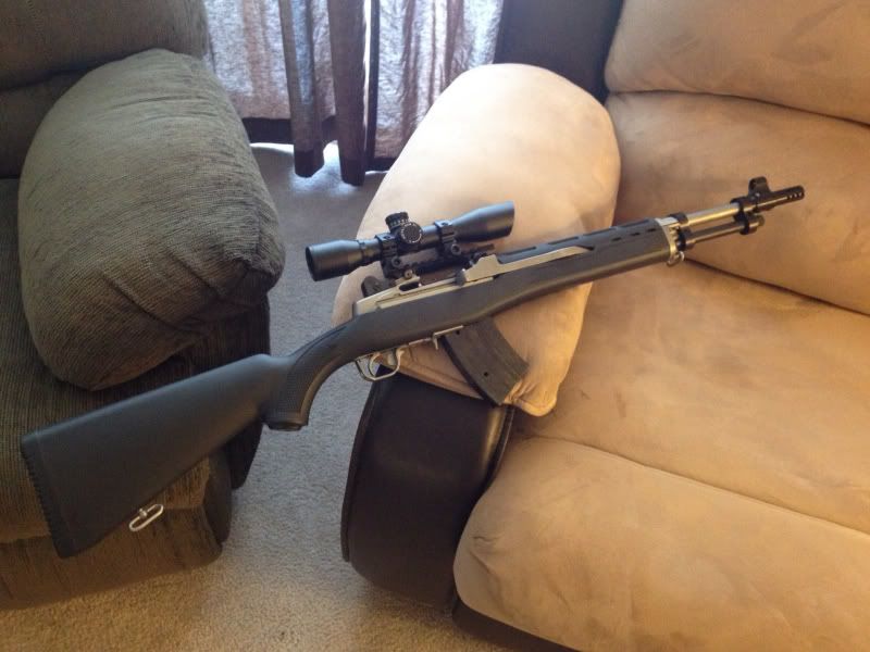

after some selling & trading & negotiations, I finally ended up with a 581 series Mini 30. synthetic stock with stainless receiver and barrel. the previous owner had installed the stabilizer on the barrel which I had read good things about. that was a plus. I had the factory 5 round magazine, as well as two aftermarket 10 round mags and two factory 20 round ma.... I mean, REBUILD kits. okay, they are 20 round mags, but modified to only accept 10 rounds, of course. I also was able to round up about 600 rounds of ammo which ended up being a combination of Tulammo, Wolf Black Box, Wolf Military Classic, Silver Bear and I also got some PPU brass cased rounds to try as well. I wanted to try as many different brands as possible to test the results. I will share those with you later.
I got the rifle out of jail after work and promptly hurried home to check it out. after a couple quick Youtube tutorials on how to disassemble it, I took it apart and check out the guts. nothing like my AR, but didn't expect it to be. one thing I learned is that there are some parts that can't be serviced by a novice. firing pin replacement, in particular, requires a qualified gunsmith. most even recommend the gun go back to Ruger!!!! fail.... not cool. but, I'll save judgement until after all my criteria have been tested at the range.

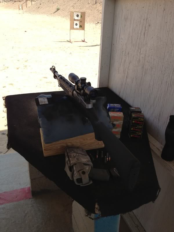

okay.... RANGE DAY! found myself a nice bench at the local range and set up a target at 50 yards to get warmed up. decided I'd start off with the aftermarket 10 round mags and see how they worked. started loading rounds into the magazine and found that they didn't seem to go in easily, or smoothly. kind of binding up.... maybe just because they are new? anyway, time to shoot. magazine inserted into the rifle smooth and easy, now just chamber a round and lets do this! pulled back on the charging handle and released it...... it locked up with the bullet only a short distance into the chamber. huh? pulled the charging handle (bolt handle?) back and let it go forward.... no luck. third time was a charm, though. round now chambered. rile on bag, crosshairs on target, smooth trigger press.... BANG!!! great... except the NEXT round in the magazine didn't chamber, either. this happened six times in a row. the last four rounds fed okay, however. tried the second aftermarket magazine with the same result. bummer. but, I had been warned that Minis only like factory magazines. guess I just proved that to myself. factory mags aren't super easy to find and they are expensive, so already a drawback. grabbed the 5 round factory magazine. rounds popped in smooth as silk!! okay, now were getting somewhere. insert magazine, release charging handle..... round chambers without hesitation. awesome! fired all 5 rounds without issue. tried the 20 round mags with the same result. lesson learned. if you require reliability, stick with the Ruger factory magazines. the aftermarket ones might be modified to function better, but so far, epic fail on the aftermarket mags!
okay, so now on to my ammo test. I fired 60 rounds of each of the above mentioned ammo. here is what happened:
Tulammo - 4 FTF's in 60 rounds. all 4 rounds fired on the second try.
Wolf Black Box - 2 FTF's in 60 rounds. both fired on the second try.
WPA Military Classic - 1 FTF in 60 rounds. fired on the second try.
Silver Bear - 0 FTF's
PPU Brass ammo - 0 FTF's
throughout the ammo test process, there were multiple times that the bolt would not go forward and put a round in battery when released. this only occurred with the steel ammo. never experienced with the brass ammo. so, the claims about the unreliability of steel cased ammo seem to have merit. I proved that to myself.
