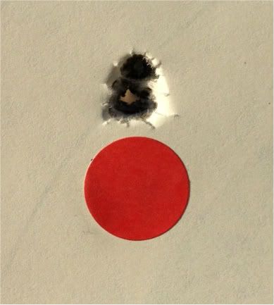

              I've got the Jard 2 lb. adjustable in a couple of my lowers. I bought the 1.5# springs to put in them, haven't gotten to it yet though. Don't know where you're located, if you're anywhere near Tracy/Livermore you're welcome to try it one day.
              100 yds. WOA 22" upper, factory Black Hills ammo...
              (yeah, yeah...I know, I missed the dot)
                      -Rick
                      What kind of optics or sights when you shot that?
                      Does it count? You missed the red target.
                        The point isn't always to hit the exact target. The reason? Well, if the guy can shoot a group that good, it's a minor adjustment to lower his point of impact. By having the point of impact not match the point of aim, he doesn't destroy the thing he's aiming at with bullet holes allowing his point of aim to remain consistent.
                          Sightron SIII 10-50x60
                          Bingo! We have a winner. It was intentional.
                            Some guys at my range (including me) purposely shoot off of the POA so that we don't have to walk down range to change the target. You shoot a group an inch or two up, move it left, shoot a group, move it down, shoot a group, etc. grouping is all that really matters.
