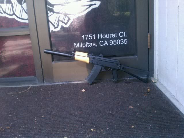

          Pinned fake can, Virgin Bulgy.

            Gio
            • 10251
            Very nice Mike!
              NICE! That's pretty much exactly what I want to accomplish!
