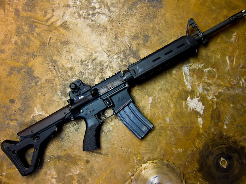

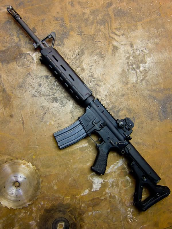

    I have just completed my first AR-15, and I officially have a bad case of the BRD.
    Ill run through the specs real quick.
    BCM 16" midlength upper with a GFCH, phantom comp, MOE handguard and LMT rear irons.
    Lower is JD machine with IAC roll marks, bullet button, DMPS LPK, Tangodown grips and a UBR stock.
    The magazine is an old 10/30 USGI
    The build itself went fairly smooth but i did run into a few problems - most of which were related to the DMPS LPK which in hindsight i really regret purchasing. the first problem was the roll pin for the mag catch. What a PITA that was. I almost wonder if it was the wrong size it was that hard to install. The second was a problem that I posted about earlier which was the safety selector switch was out of spec and would stick in the FIRE position. I got a replacement switch and the glendale gunshow and everything was working fine again.
    Took it out to range yesterday to see if it went bang and to zero the iron sights. 175 rounds without any issues. Having never fired an AR before the sprong! of the buffer spring made me laugh a bit when i first heard it, but i got used to it pretty quick. The trigger is not really to my liking as its really stiff and has a bunch of travel before it breaks, but again i blame the cheapo DMPS kit for that, and maybe it will get better as time goes by.
    So now the new problem. When I zeroed the iron sights I had to crank the windage almost all the way over to the right side. It ended up shooting straight but the rear sight looks weird cranked all the way over. I was getting about 4-5" groups at 100yds which isnt too bad considering the heavy trigger and im bit rusty. But my question is "Is this normal?" The front sight post doesnt appear to be canted but im not too sure. Any advice is appreciated.
    TLDR - is it normal to have my rear sights adjusted all the way over?

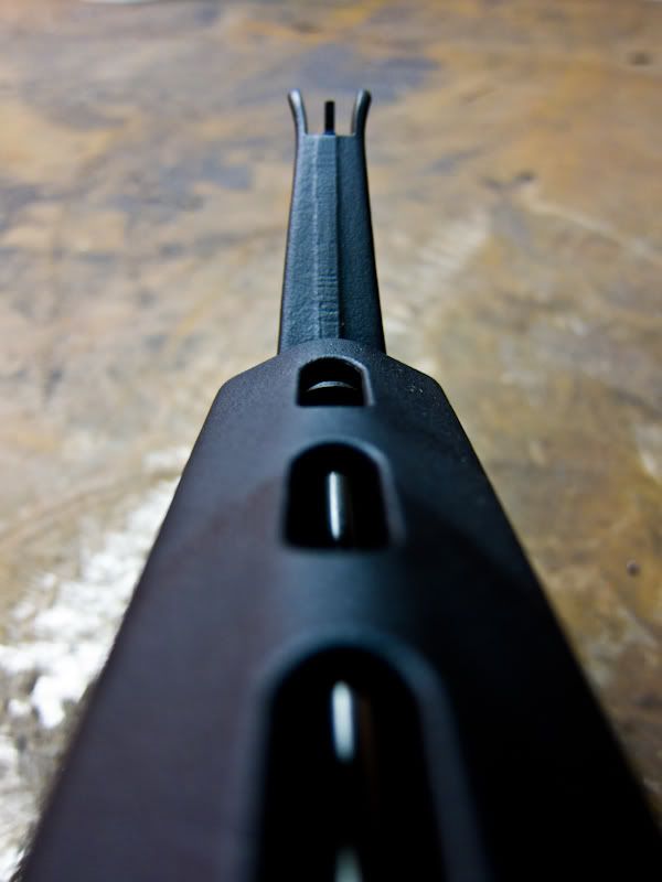

    joelogic
    • May 2008
    • 6592

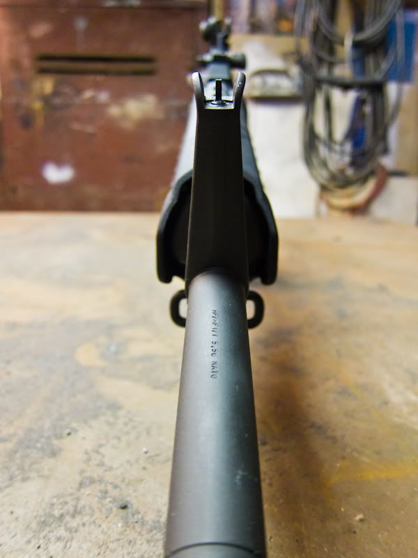

    No this is not normal. Could be the front sight or your sight picture. Have someone else shoot it and see if you get the same results. Then post some pics of your front sight.

                caribbeing
                • 123
                sight picture
                noob here - by sight picture you mean how i am looking through the sight? ie head position and cheek weld, yes?
                Did you buy the upper complete? Or did you drill the holes yourself for the front sight base?
                I bought it as a complete upper.
                  caribbeing
                  • 123
                    that guy
                    • 201
                    There is another possibility...

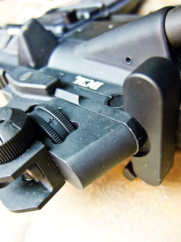

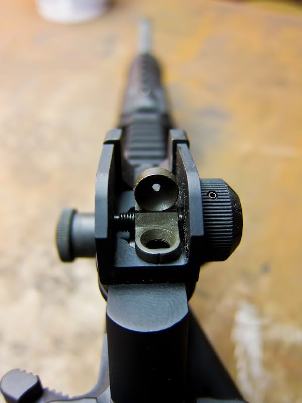

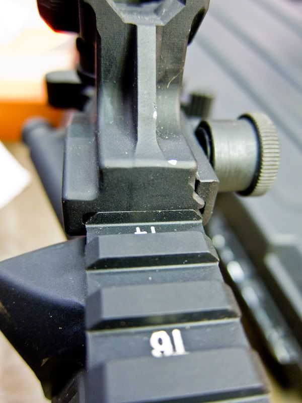

                    Have you considered that the rear irons are the "issue". It would appear from your photo the rear sight assembly is shifted to the left, requiring the rear sight to be adjusted to the right to compensate. Have you measured the rear irons to see if they are centered on the top rail?
                    I'd check to see if the problem was with the add-on rear irons or their installation before assuming the upper assembly is the problem.

                      Loosen the rear sight and wiggle it to make sure it's sitting flat. Sometimes things don't always settle right into place until you do that.
                        olhunter
                        • 3707
                        You're sight is not mounted evenly. Look at the edges and sides. They have uneven overhang and it is canted slightly. Loosen it up and line it all up evenly and carefully. If there's no way to adjust that, your sight is bad. Or get a bigger hammer.

                          caribbeing
                          • 123
                          I'd check to see if the problem was with the add-on rear irons or its installation before assuming the upper assembly is the problem.
                          I guess the smart thing to do is replace the LMT with a magpul MBUS that i have and take it out again to see if rear sight is the issue.

                            This also can happen if barrel is over or under torq.

                              sevensix2x51
                              • 3835

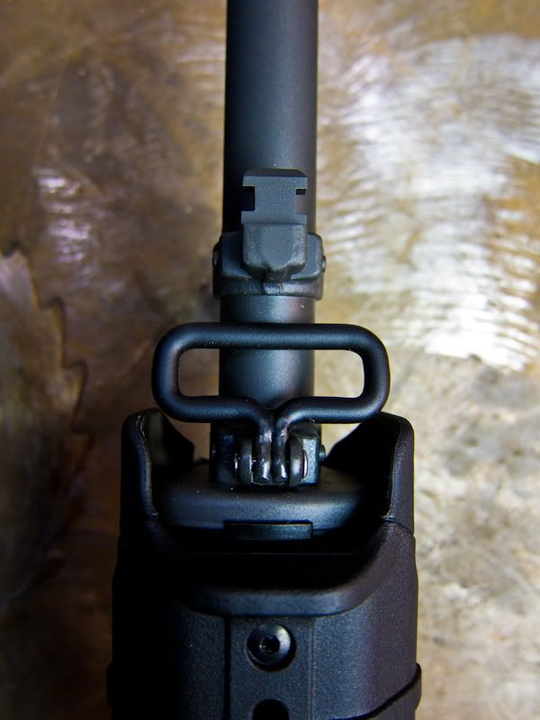

                              the front sight looks canted in this picture, at least to my eyes...
