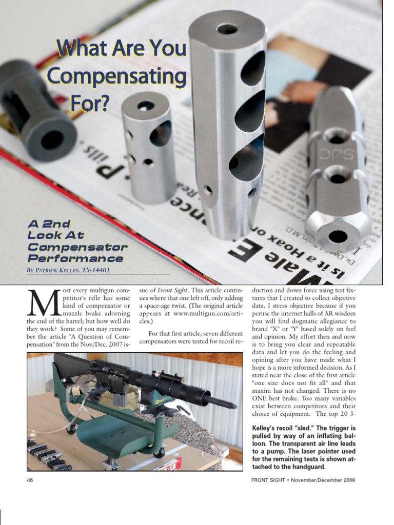

How much difference does muzzle brake makes?
  • jackliu239
    • 539
    How much difference does muzzle brake makes?
    To put on an AR-15 that is, I know they are already have very little recoil, but I was thinking of improve it further with faster and more accurate follow up shots, so how much differences does muzzle break really make, its worth it?
    perpetual otter
    • Jul 2007
    • 5093
    Yes. Muzzle rise is what it reduces more than felt recoil though.
    BTW, the topic title makes 3rd grade teachers cry.
    I provide opinions...
    At a rapid rate.
      Jpach
      • Oct 2007
      • 4707
      They can make it even more non existant. You just have to figure out of the increased concussion and loudness is worth the recoil reduction of an already light recoiling firearm.
      I use a Linear Levang comp on my 16" AR. Its designed to blow all the noise/blast forward make it seem quieter to the shooter and his/her buddies. I like it.
      Also, 3-gunners are really into their brakes because they DO work. Any little increase in recoil reduction is good. It all depends on your purposes.
      PM or Email me if you have questions: Jpach89@gmail.com
      Check out my LMT .308 AR
      Originally posted by kotton
      I have to try that method of attaching the front of a sling to the gun via pubic hair.
      Originally posted by bomb_on_bus
      Best part of buying that stock is it comes with its own complimentary jar of anal lube! There were several flavors to choose from, regular, hot cinnamon, or bacon. Im a man of danger so I chose Hot cinnamon to use with my bump fire buttstock.
        jackliu239
        • 539
        good thing I am not in 3rd grade. And yes, I know what muzzle break does, I am asking does it reduce the recoil significantly.
          killshot44
          • Nov 2009
          • 4072
          Muzzle BRAKE..........
          No, they don't reduce much recoil. They DO keep the barrel in position, as do quality Compensators.
            a308garand
            • 303
            I would work on improving my shooting position and more practice with the rifle than hitting it with parts. Some muzzle brakes can become expensive.
            I run the basic A2 flash hider. My Vortex doesn't get shot as often as the regular old stuff.
            Squaring up to the target, keeping a good cheekweld and shoulder contact into the rifle while shooting will make those follow-up shots quicker on target with less muzzle rise between shots.
            When the skills are there, a new recoil brake could make a minor improvement. Seek out some quality instruction and you will see what other folks are running on their rifles; maybe even allowed to take a test drive of them to see what works for you.
              shark92651
              Vendor/Retailer
              • Oct 2006
              • 5431
              No it doesn't reduce recoil significantly, not that a 5.56mm AR has much recoil to begin with. And it's a muzzle brake, as in it puts the "brakes" on muzzle rise, not break.
              www.riflegear.com
                SuperSet
                • Feb 2007
                • 9048
                For fast follow-up shots, a compensator is the way to go. Note the barrel movement of non-compensated barrels vs. various compensators here:
                  jackliu239
                  • 539
                  Thanks, exactly what I am looking for, going to change the title.
                    UserM4
                    • Apr 2010
                    • 1687
                    I bought an inexpensive YHM muzzle brake from RifleGear and was very skeptical. But at the first trip to the range with my new brake, shooting while standing, a range officer came up to me and asked what kind of brake I had because from where he was standing, he couldn't see my barrel rise at all. It's right there that I realized how well my sight stayed on target with the brake compared to my old birdcage flash hider. I'm now a believer. I'm sure that an expensive brake will be better than the YHM but there's a significant difference between a standard A2 flash hider and even this inexpensive yet effective YHM brake. Thanks RG!
                    While we're here arguing about the latest high tech running shoes, there's some Kenyan out there running barefoot. Guess who's gonna win the marathon?
                      perpetual otter
                      • Jul 2007
                      • 5093
                      Originally posted by jackliu239
                      Thanks, exactly what I am looking for, going to change the title.
                      Let me do it for you...
                      "Considering the inherent qualities of the recoil (or there lack of) of the 5.56, will the utilization of a muzzle brake make a significant difference?"
                      I kept it a little basic.
                      I provide opinions...
                      At a rapid rate.
                        jackliu239
                        • 539
                        Read my first post FOLLOW UP SHOTS, and yes I already acknowledge I am aware 5.56 has very little recoil within the first post.
                        So go back to the 4th grade, and learn how to read before you post.
                        Last edited by jackliu239; 09-03-2010, 12:02 PM.
                          thrillhouse700
                          • 4349
                          I have this one, It is freaking awesome for 17 bux.
                          We did a heads up with my buddy's AR. He has a birdcage on his and there was a very noticeable diff.
                          "I *love* the idea of DOJ buyback money being used to buy guns for kids. " - Steadyrock
                            DougJ
                            • 1812
                            I had a just thread protector and then put an RRA Brake on my AR. It's a featureless build so no flash suppressor. I didn't think much about it since the 5.56 has so little recoil, but the brake was cheap... However, I was watching my wife shoot it after I put the brake on and was surprised how flat the rifle stays during recoil. It makes a differance.
                            01001001 00100000 01110111 01101001 01101100 01101100 00100000 01001110 01001111 00100000 01001100 01001111 01001110 01000111 01000101 01010010 00100000 01100011 01101111 01101101 01110000 01101100 01111001
                              TMC
                              • 2348
                              They do help speed up follow-up shots
                              Pay no attention to the shotgun and pistol potions
                              where are my pistol mags?
