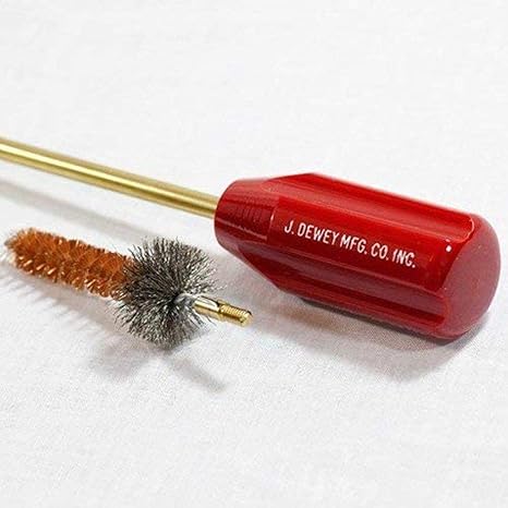

      Clearly, almost half the responses so far have no idea as to what brush the OP was discussing.
        • #19
          slamfire1
          • Aug 2015
          • 794
          Originally posted by theLBC
          Good picture of a military type chamber brush. As stated earlier, the steel bristles are only to clean out the locking lug area.
          Never ever allow a steel brush to enter a rifle barrel chamber. Rifle barrels are soft and a steel brush will scratch the chamber. This still applies if the chamber is chromed.

              Stainless steel AR chamber brush will not damage the bore when used properly.
              Folks also need to be aware their are different types of stainless steel bore brush, like tornado brushes

                I hate those chamber brushes, the steel bristles are so stiff it's difficult to actually get them to fully brush the lugs. I have more success with a plastic chamber brush. Though I suppose if you shoot your gun un-lubed and don't clean a long time the carbon would be caked on harder and need more scrub power than the plastic gives.

                  If there was a issue with chamber damage they wouldnt be standard issue. Been running them for years. The steel on the brush is way softer then the steel used for the chamber.
