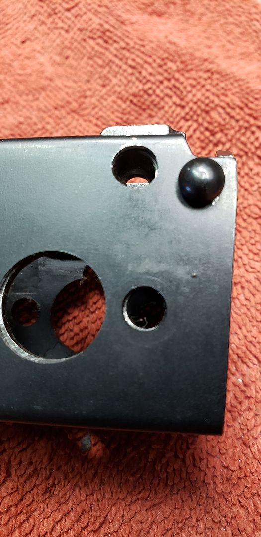

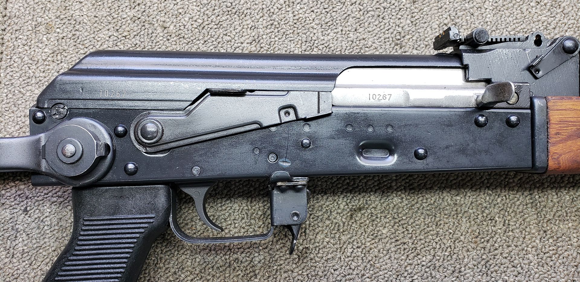

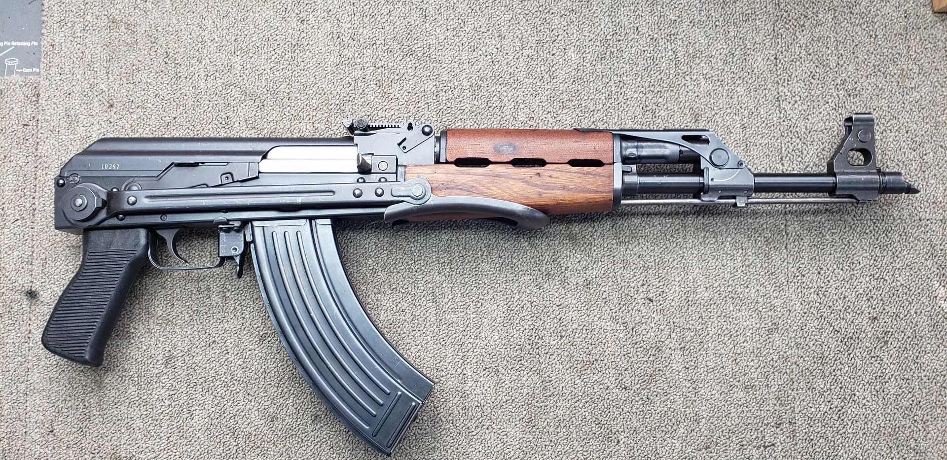

    Built this little blaster in the past few days. Original barrel all matching kit. The M70AB1 is a AKM based model with the standard weight receiver and non bulged RPK type front trunnion. Similar to the M92.
    One thing which was unusual about this kit was the serial number location on the kit. Usually they are numbered on the left side of the front trunnion, however some (very few) Yugos had their serial numbers on the actual receiver...
    Also had to cut the receiver to accept the rear cover latch.
    Went together real nice. Building using a original barrel is a real snap!!

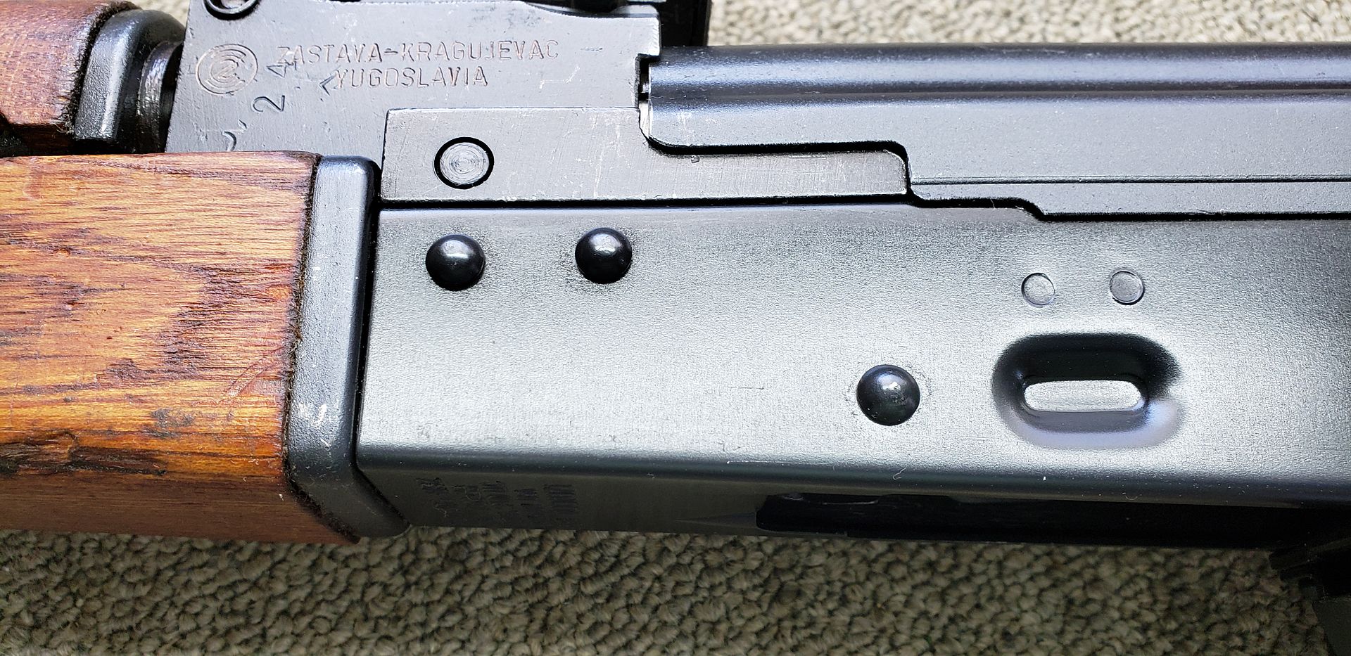

    Nice job! the riveting looks nice.

      With the foldies can you fold and unfold it with the mag in?
        isplice
        • 398
        Yes you can.
              Thanks!! I really try and get the rivets perfect. A few pic's of the rivets.

                  repoman1984
                  • 1051
                  Very nicely done, especially the rivets, look very clean.
